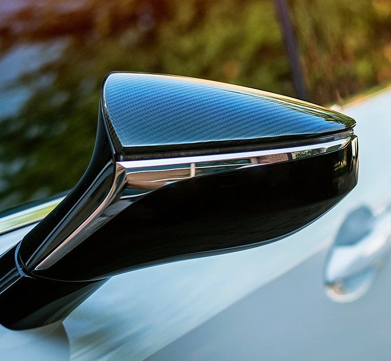

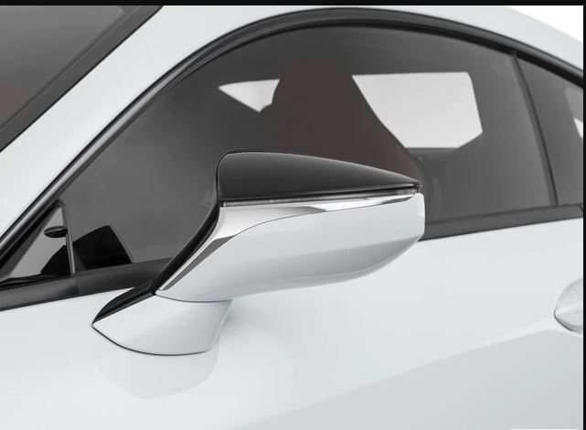

I was on the IS group and saw that Lexus does in fact make a top portion for the mirror caps that are genuine OEM CF. It appears that the IS uses the same mirrors as the face lifted RCs....
Currently the face lifted versions are black on the top mirror cap. This is the only CF item I'd actually like to add on the car. The rest just stick out too much to me (spoiler, spliter, on an otherwise all white car.) I am not a fan of the caps that are "M" copies, they look like an after thought to me.

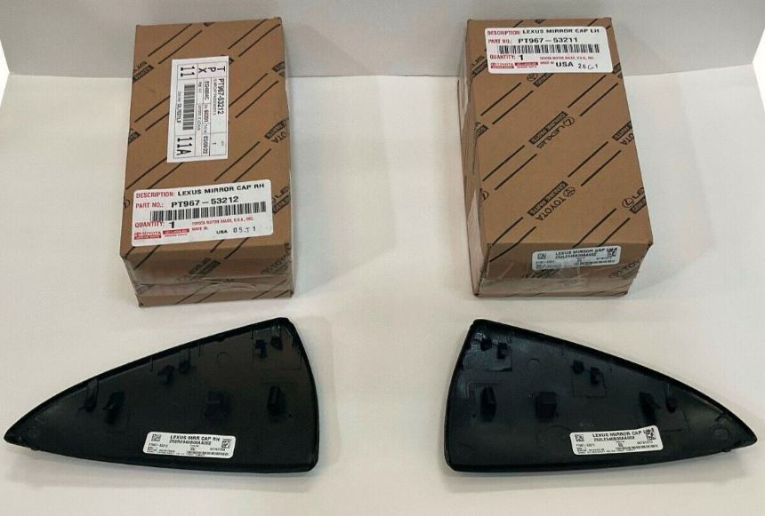

Part numbers are:
PT96753212 - Left
PT96753211 - Right
States they are for IS300-350 2021/2022.
IF these fit the RC/RCF. it would be a really nice add on to the track editions since they already have a lot of CF.
The mirrors look identical to me though.
RCF:
IS:
Anyways. I figured I'd give it a go. Anyone remove the top of the mirror caps? I read that it's just a single screw but I wanted to make sure before buying since they are not cheap and I'd rather not get stuck with an item that I can't use. Local dealer is of course saying not compatible at all....lol But they also said that with the credit card key that works 100% with my car.

Yep that's where I saw it too! Didn't even realize it was a thing. They are pricey for sure but any OEM carbon piece is gonna be expensive. I have no interest in a rep or other manufacture.. most of the time it just isn't great quality considering what one spends for it. So far I have found these for around $420 each. I think depending on when sales happen you could save up to 15% off via OEM parts. Many dealerships run that. I know I got an email at christmas from Belle Lexus since I bought stuff from them before, they were offering 15% off all OEM parts/accessories. I kicked myself slightly for not waiting to buy the credit card key but I had already bought it from them.
Yep they shouldn't come off at all. It's held in with a center screw and clipped into the housing. Cap meaning it's the top portion of the mirror, not something that just sticks on like the cheap ebay/amazon ones. This is an OEM part that replaces the black top portion of our mirror that is also held in with one center screw and then clipped into the housing. So this would never fly off or come off short of someone physically hitting the mirror and breaking it.

I took my covers off and they match identically to the CF ones, I ordered from Belle Lexus so hope to have them next week. I'll take pictures once I get them. The back portion as the exact same tabs, screw location as what I am looking at for my black one. This is going to be 100% plug and play/ compatible.
If lexus was smart they'd list these under other models as an upgrade. Appears the IS, RC, LC can from around 2019-2022 can take these top mirror caps. You replace the black ones that come with the mirrors.

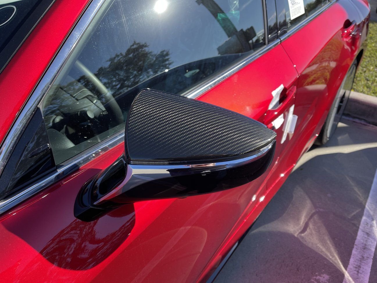

Jesus. Your dealer is marking up parts then. Retail on them is $525 each side. The cheapest I've seen them is $420 each. I was the one that took the pictures of the red IS that the OP posted above, and the fitment is great so the price is worth it imho, but not at $710. Thats ridiculous.

Yes, they're all interchangeable!
LS LC ES IS RC UX all uses the same cover/cap.
