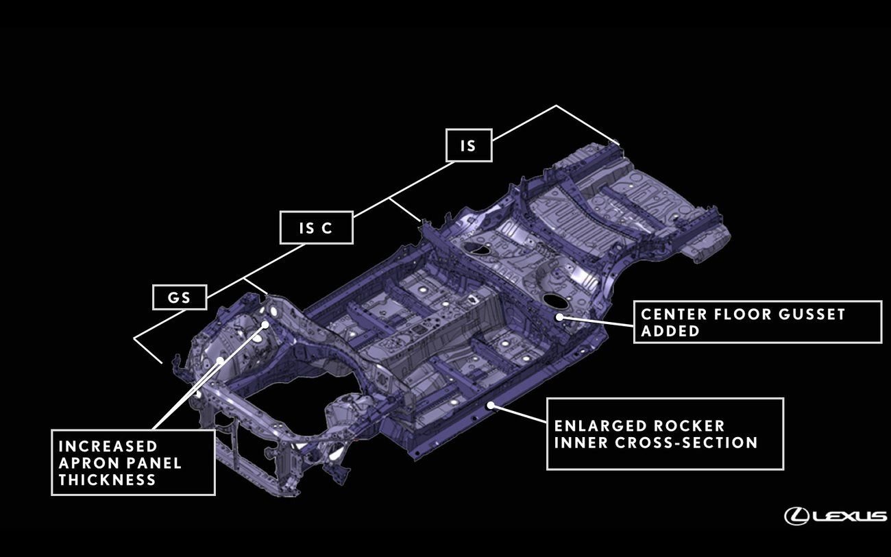

I believe a RCF and GSF axle backs are almost identical yet the GSF is slightly shorter. .
GS was a 5-series competitor. RC/RCF is a foot shorter (185.2 in vs 193.5 in) than GSF so the GSF guys have to modify RCF exhausts like Invidia mid-pipe to fit the full length. RCF's monococque was created using GS front with some additional reinforcements (for long hood/fit the V8 engine), IS-Convertible mid-section (for a very stiff core) and rear from the 3rd gen IS (for compact dimensions/shiort overhang).
