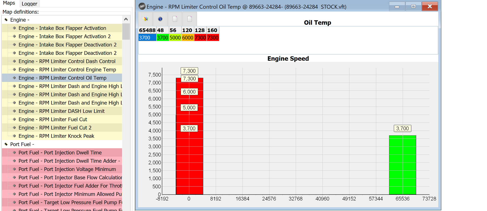

Maybe RR can make the change for you like Brendanf suggested. I do see the option to change if in the orange virus software. I guess they would just change the values to 7300 all around?
Thanks for posting that. Do you mind sharing the settings below that one for oil temp?
Old Nov 12, 2020 | 02:38 PM
javrabbit's Avatar
javrabbit
Posts: 121
Likes: 130
From: AZ
Sure, no problem.
