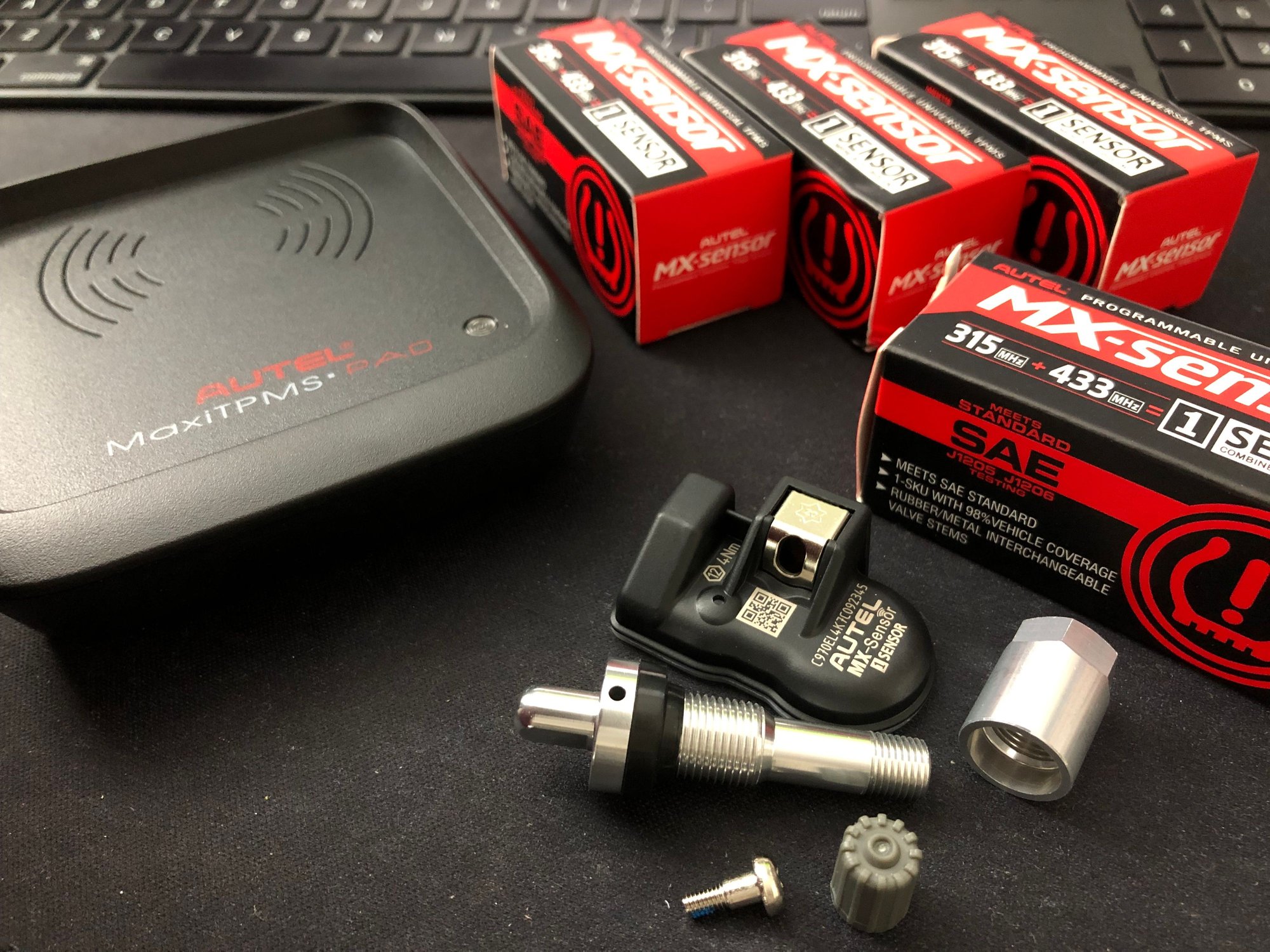

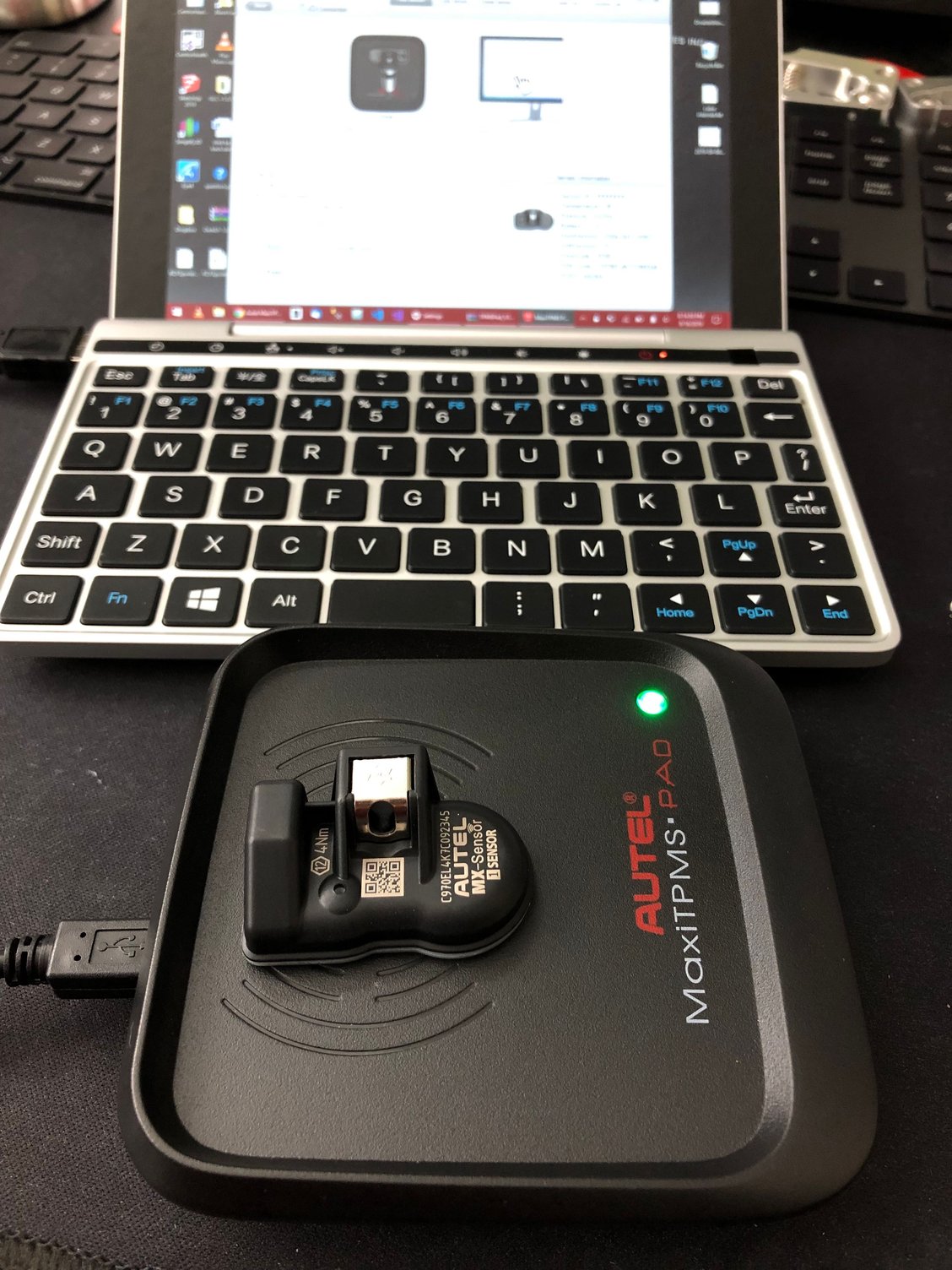

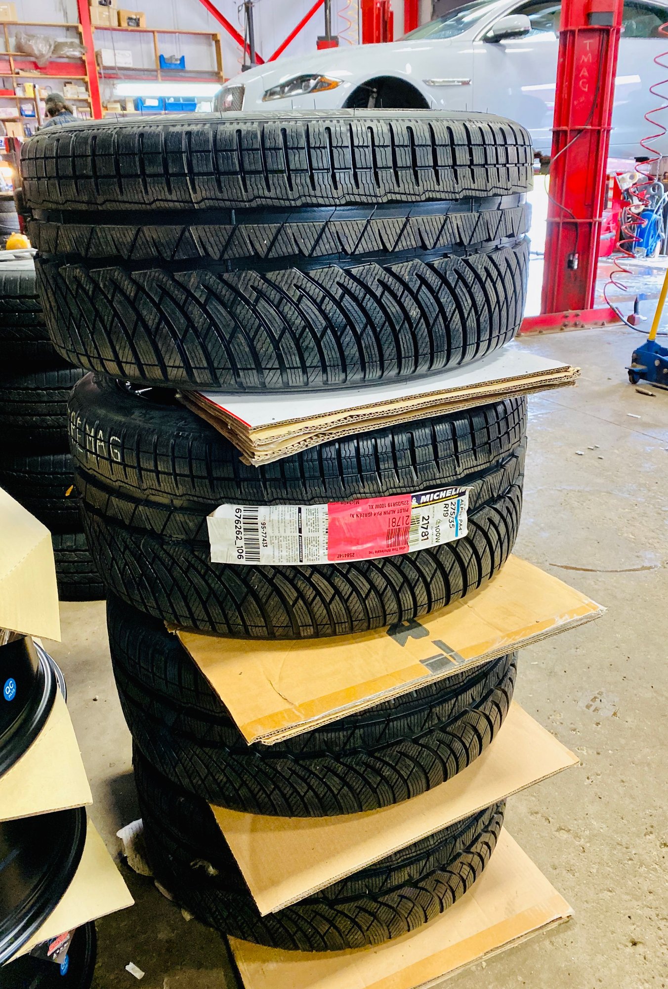

I have recently installed the same autel aftermarket sensors that i have posted above. Get the Carista App with the OBD2 dongle and read what your current IDs are. It could be that the car's sensor IDs are blanked / wiped out, if so, generate random IDs and program the car as well as the sensors using Carista, and the TPMS wireless programmer (if going with the same Autel sensors as above).
Below are some quick pics of pre-and-post install. Ready for winter.
Post back with your findings, best of luck!
