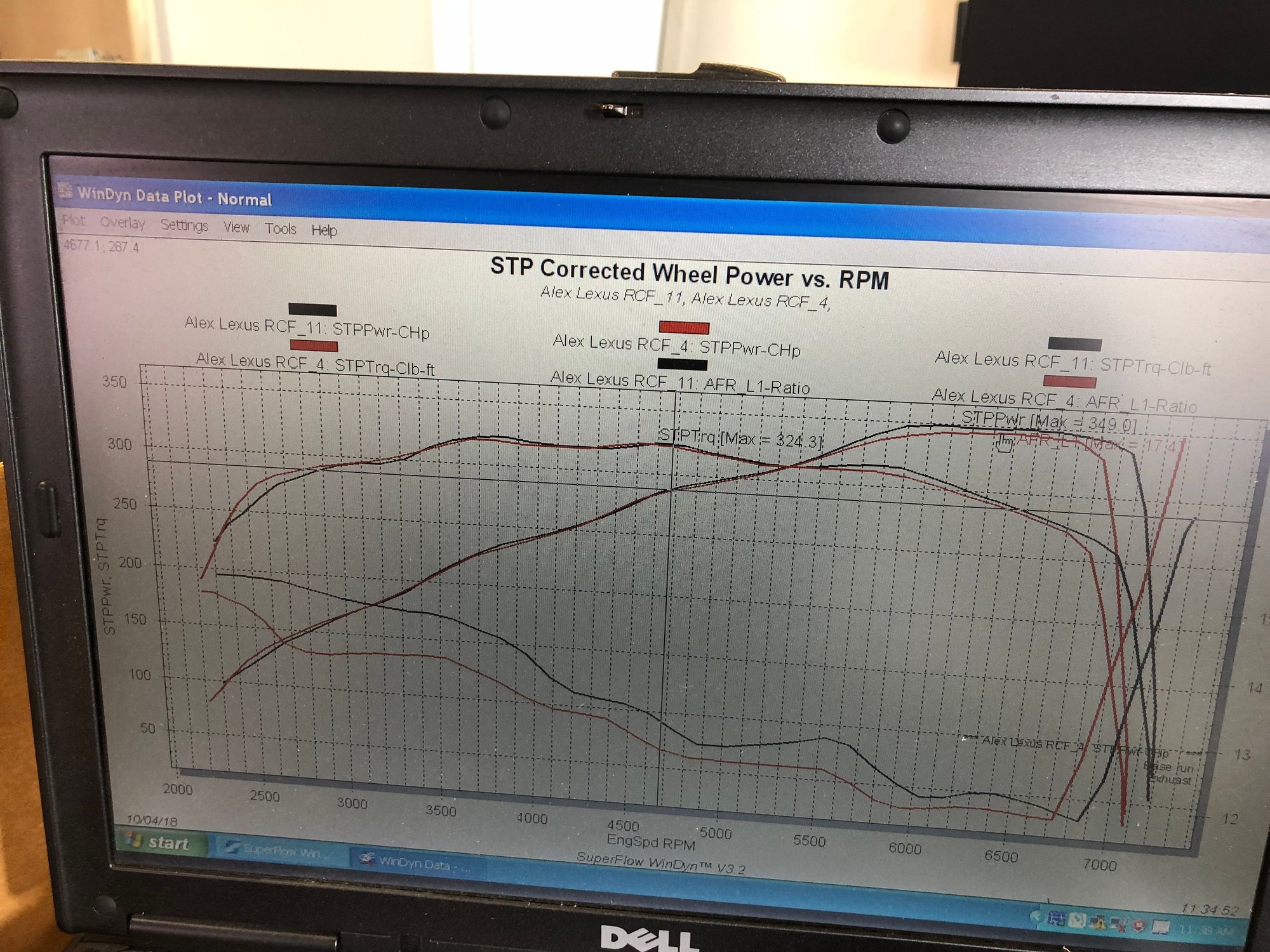

Two best runs from dyno with exhaust. Red is with Invidia and Dark Blue is with Invidia/HFC/PPE UEL.

Thanks so much for sharing this with us. I don't see near enough of it as compared to other car brand communities. It looks like mostly torque improvements, which this car desperately needs so that is good. I also note the curious (probably headers) move of top end power higher in the rev range. Not sure if you ran to red line as they hit a wall and drop off at different points and that should not be possible. I think I'm sold on your setup except I will choose EL headers because I do want the more exotic tone. Yours sounds great, thanks again for sharing!

Well the red line shows it loss some low end torque here are my cliff notes:
Loss some low end torque as you can see from the graph
Picked up HP on the high end
How did it have more revs in the upper band before dropping off gets me??? I just compared the other youtube video on the dyno with exhaust only and it hits the rev limiter, so I'm not sure why they have different drop off points (Any feedback)?
The dyno operator said the car liked the headers to be warmed up (that is why in the sound bites clip he was warming it up more) and it did make more power the next run after the first 3
I think the cats are restricting it some but it holds value as i couldn't stand the smell or the tone it made with out them
Also I believe i mentioned this in my other posts but the car had some 100 octane (since I had taken it to the track) in the previous dyno, this time today I only had 91 octane so I'm not sure if it made a little difference
Just had two screens open with both dyno runs and the car sounds way more aggressive with the headers
I hope this helps the community, Thanks!!
