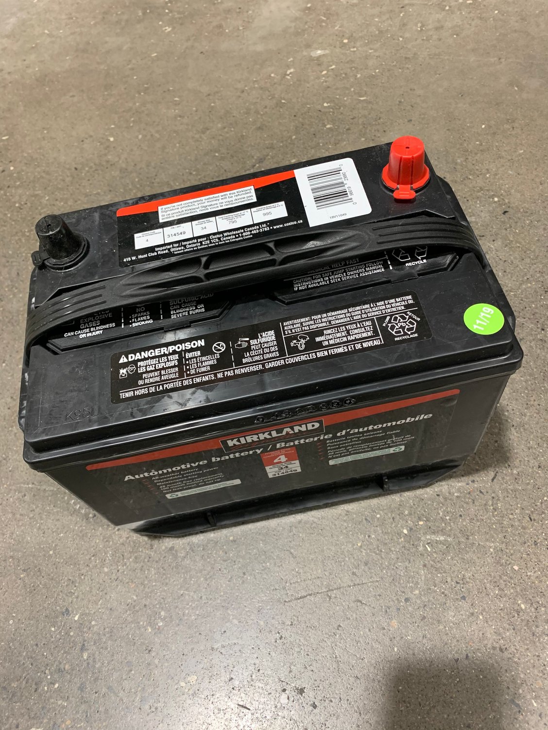

My 2015 oem battery gave up recently too. Went to Costco in Toronto and got this battery. Same cold cranking amps and same dimensions as the OEM battery. “Group size” = 34 and “Fitment code” = 4. Swapped out in 5 mins and have had no issues at all since. The radio presets or seat settings didn’t reset either.

I have the same ....2015 rc 350 f sport....will pick that battery up tomorrow...thanks...!!!
