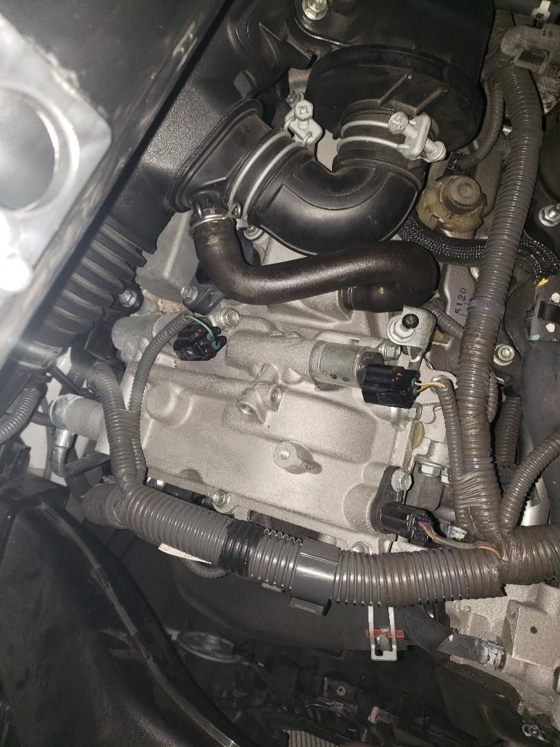

I had no problems with the polished version (dry filter) once I used the HD hose clamp. Here's a picture

your's was molded like this as well? do i just bend the molded that goes to the intake and it will fit?

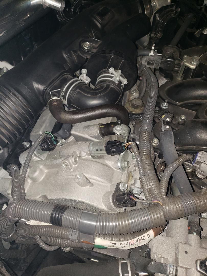

heres a better pic

The CAI was the first mod I had ever done, and I am fairly new to the forums as well, so no worries there. My hose was molded but still flexible enough to bend to where it needs to be. Looks like it has straightened out since bending it. It slipped off so easily because it didn't want to bend to fit the new CAI. The clamp solved this just fine.

I also had to bend it to fit.. seems to be holding fine so far
