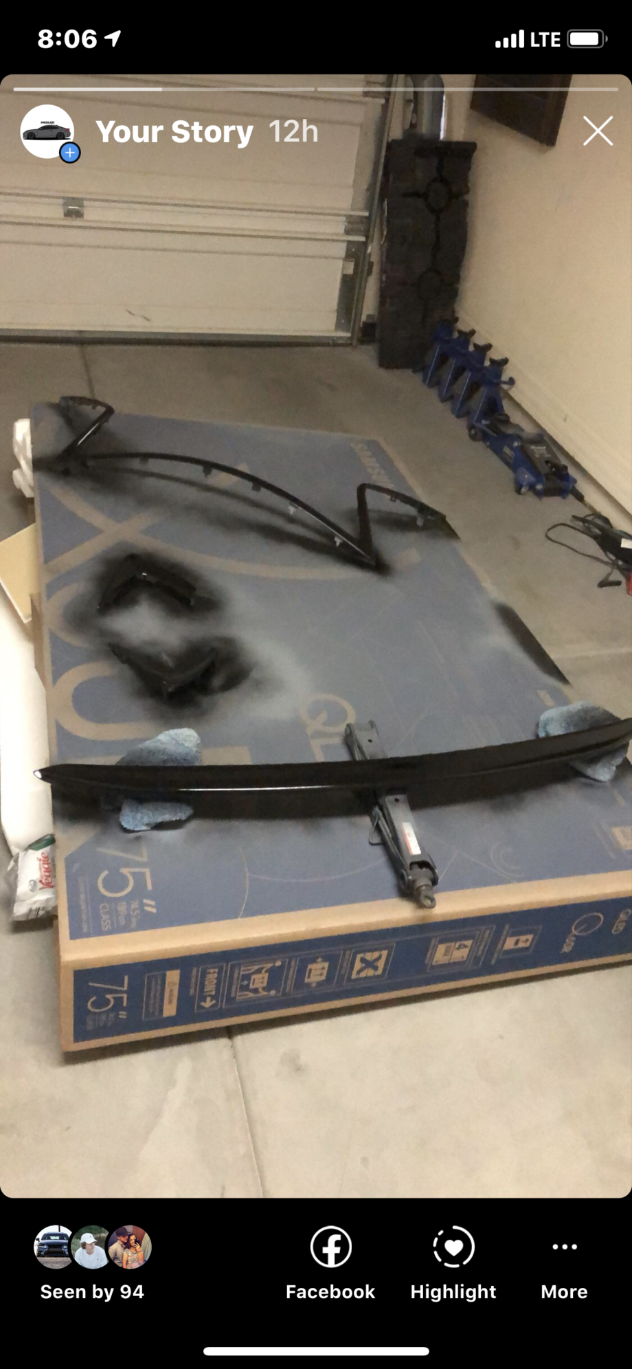

So, funny enough, I was in the same boat as you. I had the base model grille, and swapped it for the fsport grille, but i still needed to paint the chrome trim that surrounds it. I had it painted, was good for about a year and a track day before the paint chips became unbareable, and it needed to be resprayed. I'm actually in the process of respraying as I write this. I have found the most success in using a plastic primer/filler aerosol spray. This works best after sanding down the surface youre going to paint. I would suggest using something like 600-800 grit. After this, I did 1 light coat, 1 medium coat, and finally one heavier coat. After this, I let the primer cure for 24 hours, before spraying my base coat. I did about 5 coats of black enamel coating spray paint, first layer being light, following layers being light-moderate. The paint is now curing, getting ready for clear, which I will apply tonight. Last step is the clear coat. I am using some automotive grade clearcoat, in half size spray cans. Always start light, but I would do about 3-4 coats of clear. Before spraying anything aerosol, put the can in warm water, then shake for about a minute. Spray comes out a lot more consistently.
