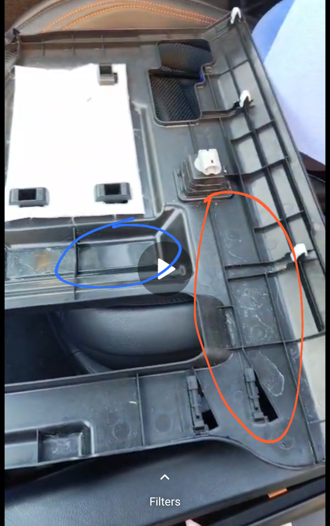

I removed the cover under the glove box that has the footwell light in it, I saw old water stains, which you can see circled in orange and the area circled in blue was filled with water before I cleaned it up.
Apologies for the very long post and bad quality images (I took them from a video).
Has anyone experienced anything like this before? I'm just a bit lost on where to go from here.

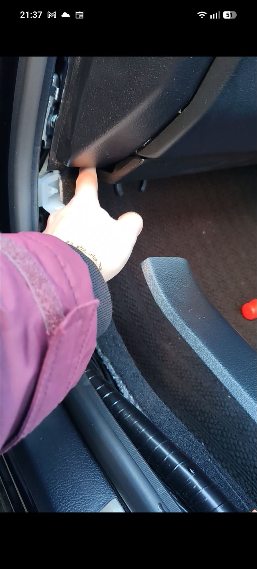

Thanks for this, unfortunately the water for me is coming from the opposite side, not the centre console but from nearer the door where I have my finger pointed here. As I was pulling on it there was water behind it, not a lot but enough to notice. That's when I removed the cover with the footwell light and saw water stains and the small pool of water.
