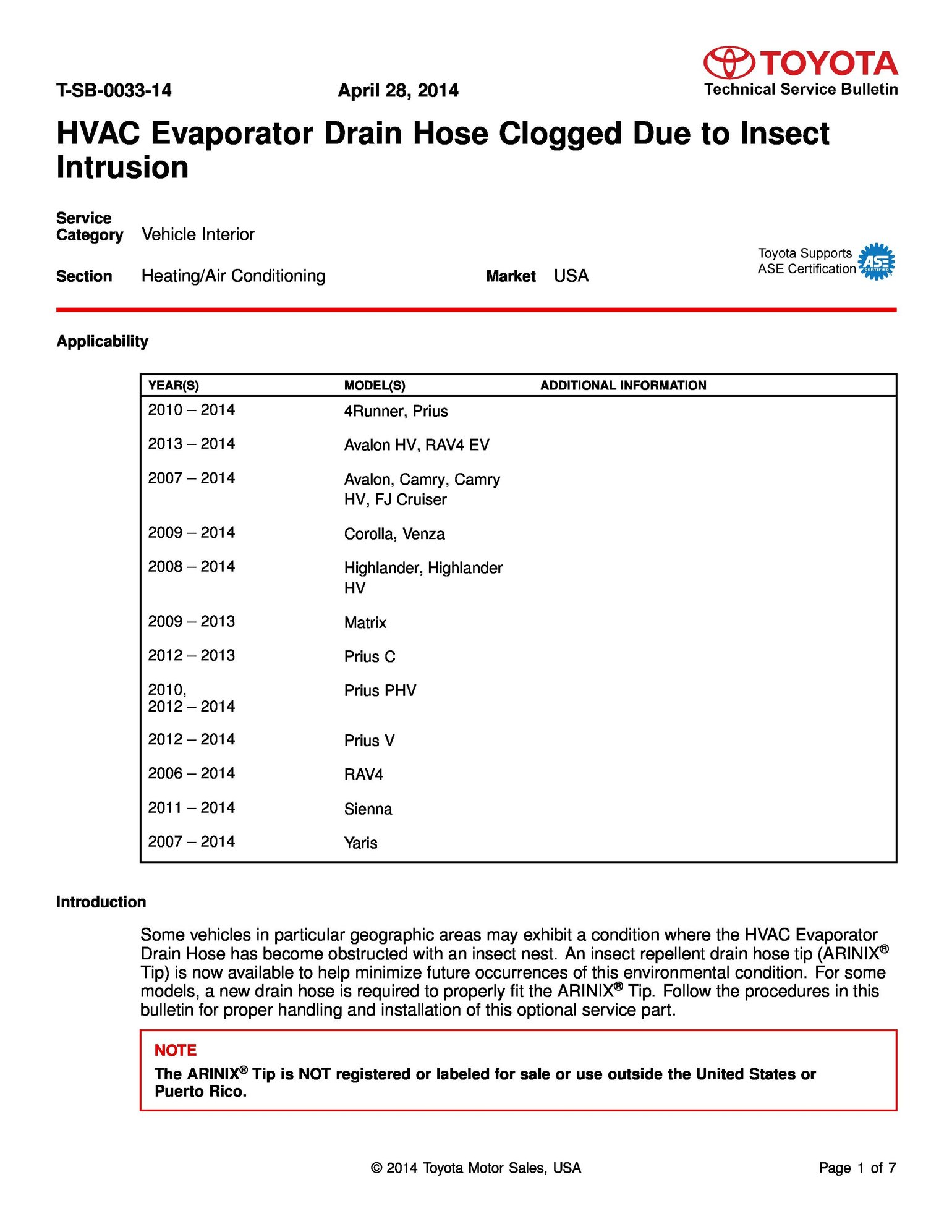

If you are under warranty you can get new carpets and anything damaged from that. You are one of many people with the drip tube intrusion. There’s a spider nest that’s blocking your drainage.

it’s a spider nest. The drip tube is 1/4 in diameter and it gets clogged by a spider nest. Layers of webbing/nest. Pull the tube, blow it out with air blower and now the water can drip. It’s called drip tube water intrusion.

when I perform repairs I examine what is stuck inside the tube. It’s a spider web nest.
