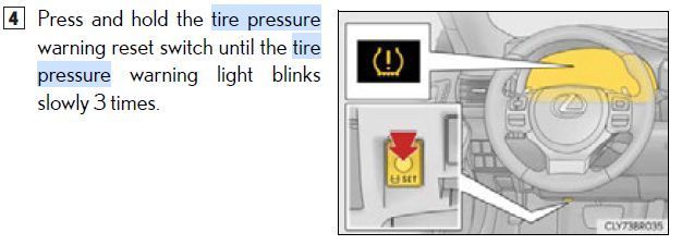

Hello, I have a 2015 RC350 FSport AWD Canadian model. The owners manual (pg 493) describes a push button reset switch under the steering wheel to initialize the tire pressure warning system. I have looked and looked. There is no switch.
How do I reset the tire pressure warning system?
The manual states, adjust the tire pressure, turn the engine switch to ignition on, press and hold tire pressure warning reset switch until the tire pressure warning light blinks slowly 3 times. Wait for a few minutes with the engine switch in IGNITION ON mode and then turn the engine switch off.
The tire pressure warning system does work, as I had a warning light before a tire going flat on a trip, and the individual tire pressures are available on a dash screen.
There is no reset switch under the dash
Reset switch location per the manual.

Use a mirror and flashlight and look further underneath and you should see the reset button next to the OBDII Port or floor light bulb.

CLightning, today you get a STAR!
Yup, it was right there.
Apparently it is not intended to be used frequently or pressed inadvertantly. I was going to post a picture but yours will suffice for this thread.
