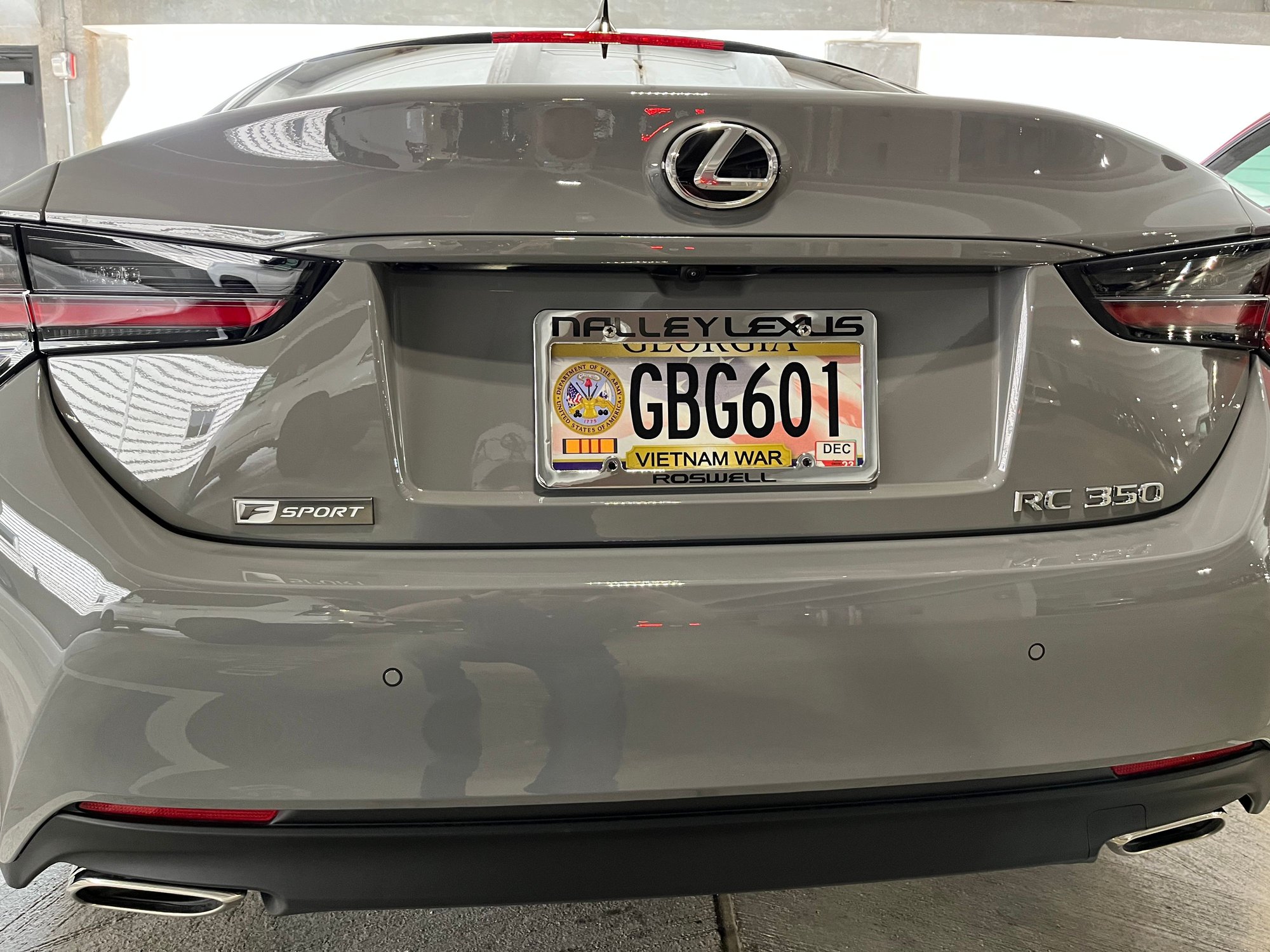

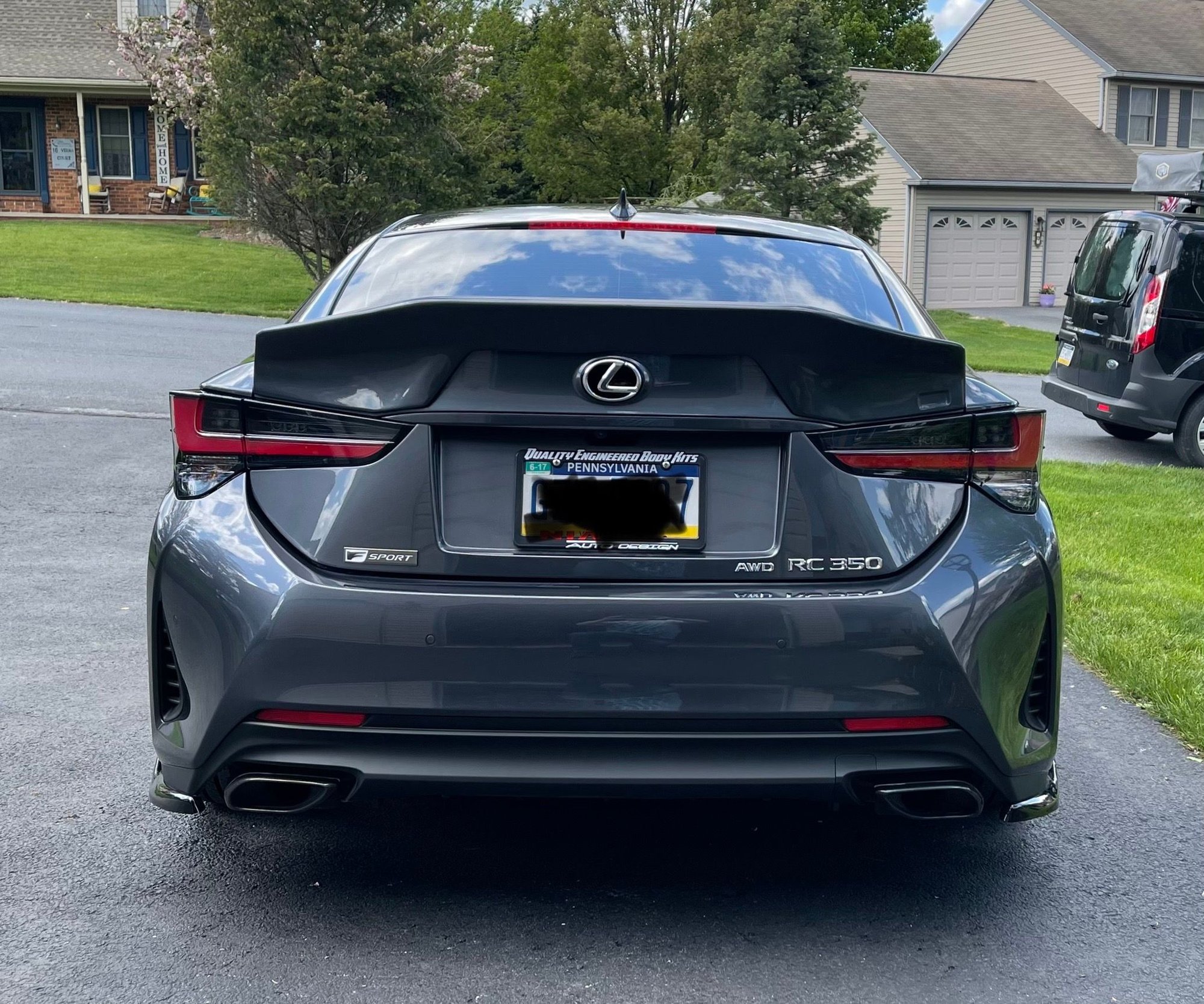

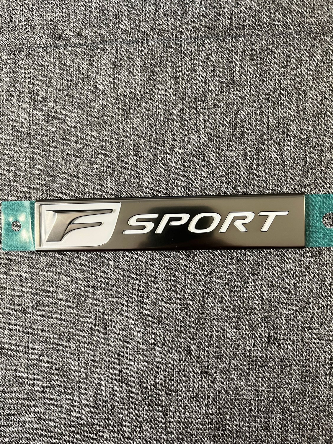

Dose anyone have the F Sport Logo on the rear trunk lid on their RC350 F Sport? I purchased the logo and am trying to determine exactly where it goes. A picture would help. Many thanks.

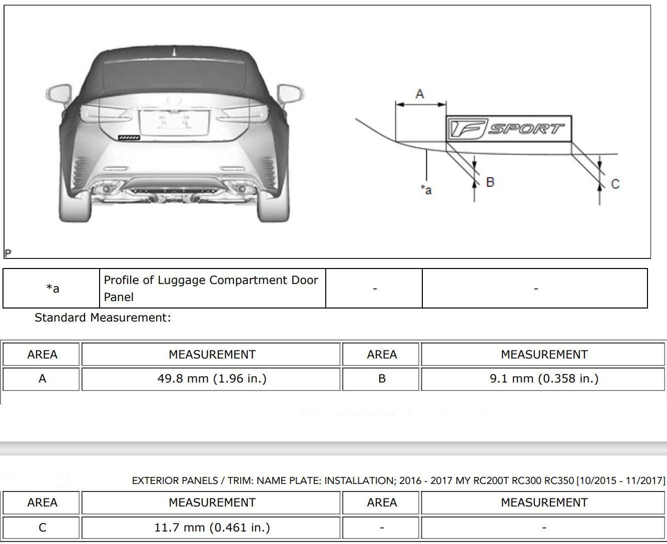

I can provide you the info if you (or anyone) verify that the trunk door of your refreshed 2023 RC has the same dimensions as the first models, 2015-2017 (before the refresh) RC?

My 21. I don’t know if the placement has changed at all but I doubt it has because the trunk hasn’t changed.

Fair enough. Here's the official specs then...

Thanks everyone. That's a great help.
