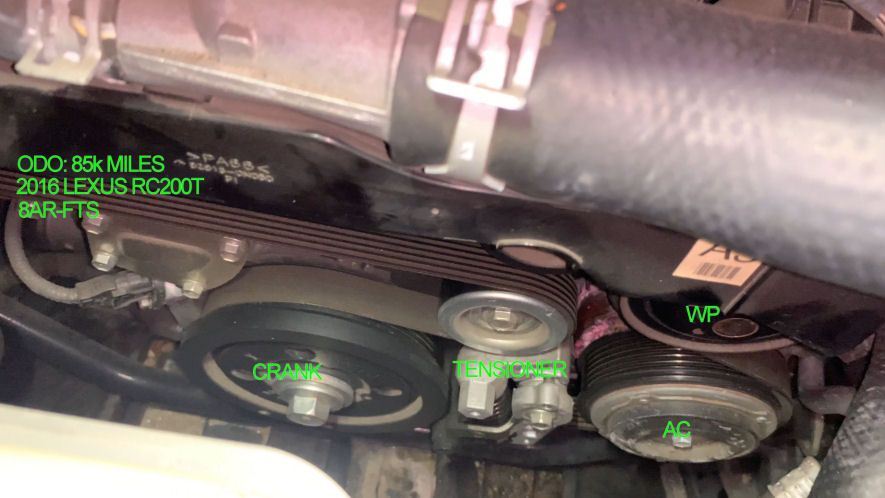

To my fellow weekend DIY'ers: Looks like I have a project this weekend on my 2016 RC200t. I will be replacing the following parts on an 8ARFTS motor:
WP (Aisin)
OEM Pink Coolant (Toyota)
Maybe:
Tensioner
Serpentine Belt
Can anyone please provide me the torque specs for the WP and Tensioner bolts? Thanks.

As I was pulling out of my parking space at work, I saw a small puddle of something under the front portion of my car. I didn't think it was mine because I was in denial thinking: ".. that cant be my car, its a new Lexus! It was probably another car that was parked before me." Then I thought: "...wait a minute, my car has 80K+ miles on the odo. It's not a new car anymore!"
The next morning on the way to work, the car was not overheating nor engine check lights lighting so I thought I was in the clear. ...UNTIL I got to the parking structure at work. As I traveled up the structure in a spiral pattern towards the fifth floor, I noticed the heater went COLD and as I was backing up into my parking spot, the temperature gauge began to rise and the radiator fan kicked into high. I shut off the engine, popped the hood and low and behold, the reserve tank was a few ticks below the low line and I saw pink stuff seeping out from under the water pump.
In a nutshell , my symptoms of a failed water pump were:
1. Cold air blowing when the heater is on.
2. Car overheats.
3. Little or no coolant in the coolant reservoir.
4. Pink Fluid leaking from underneath the drain holes of the splash shield.
5. Pink crust formed or active seepage from water pump housing.
