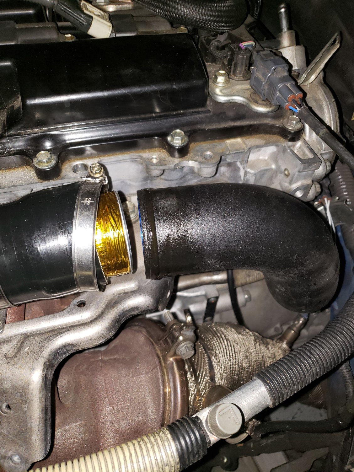

I've experienced the same jerking while downshifting in manual mode. For me, the problem was the charge pipe had loosen on both ends. Looks like it was loosened by a little bit of oil. Jerking went away after tightening everything back up
