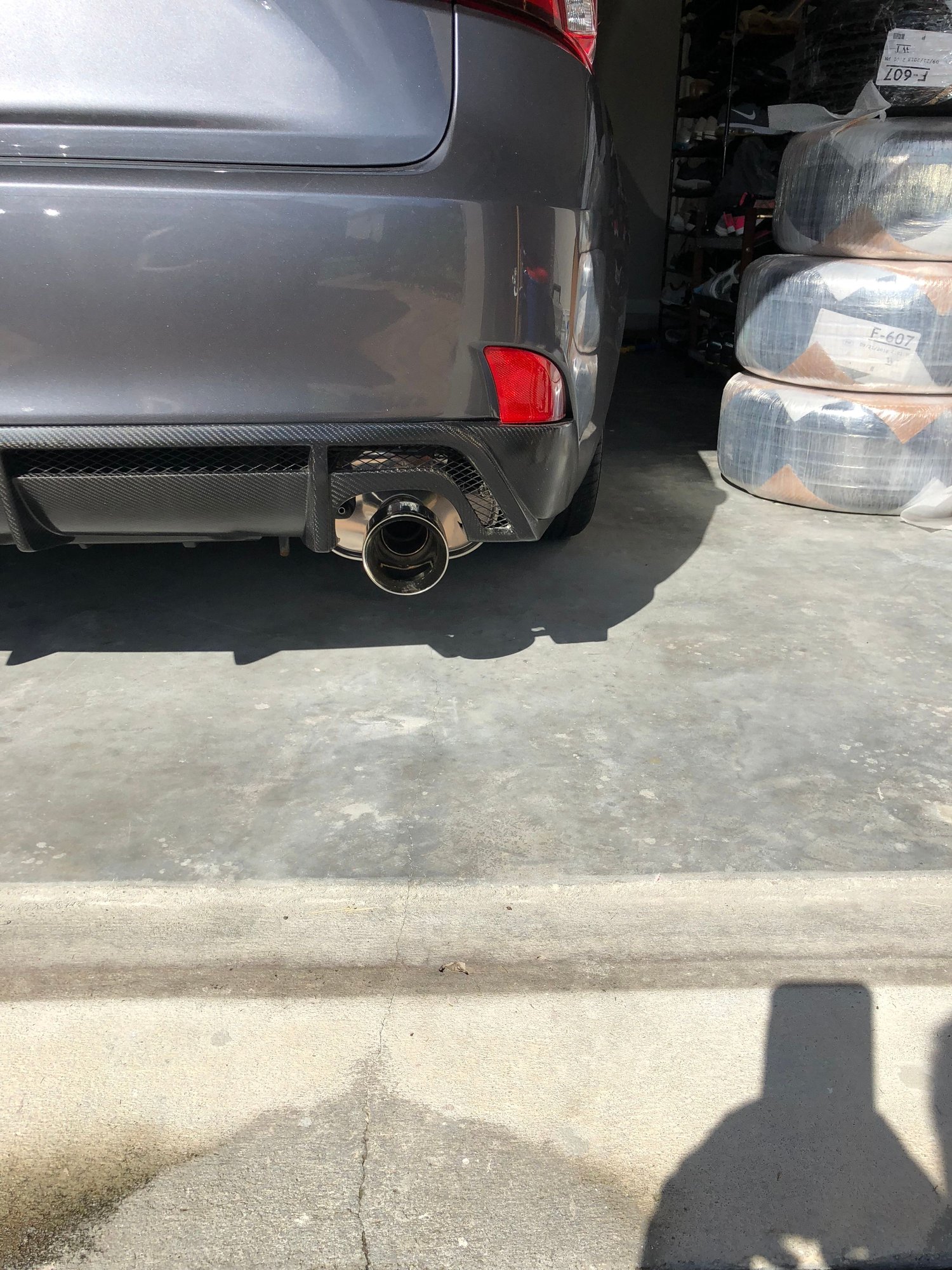

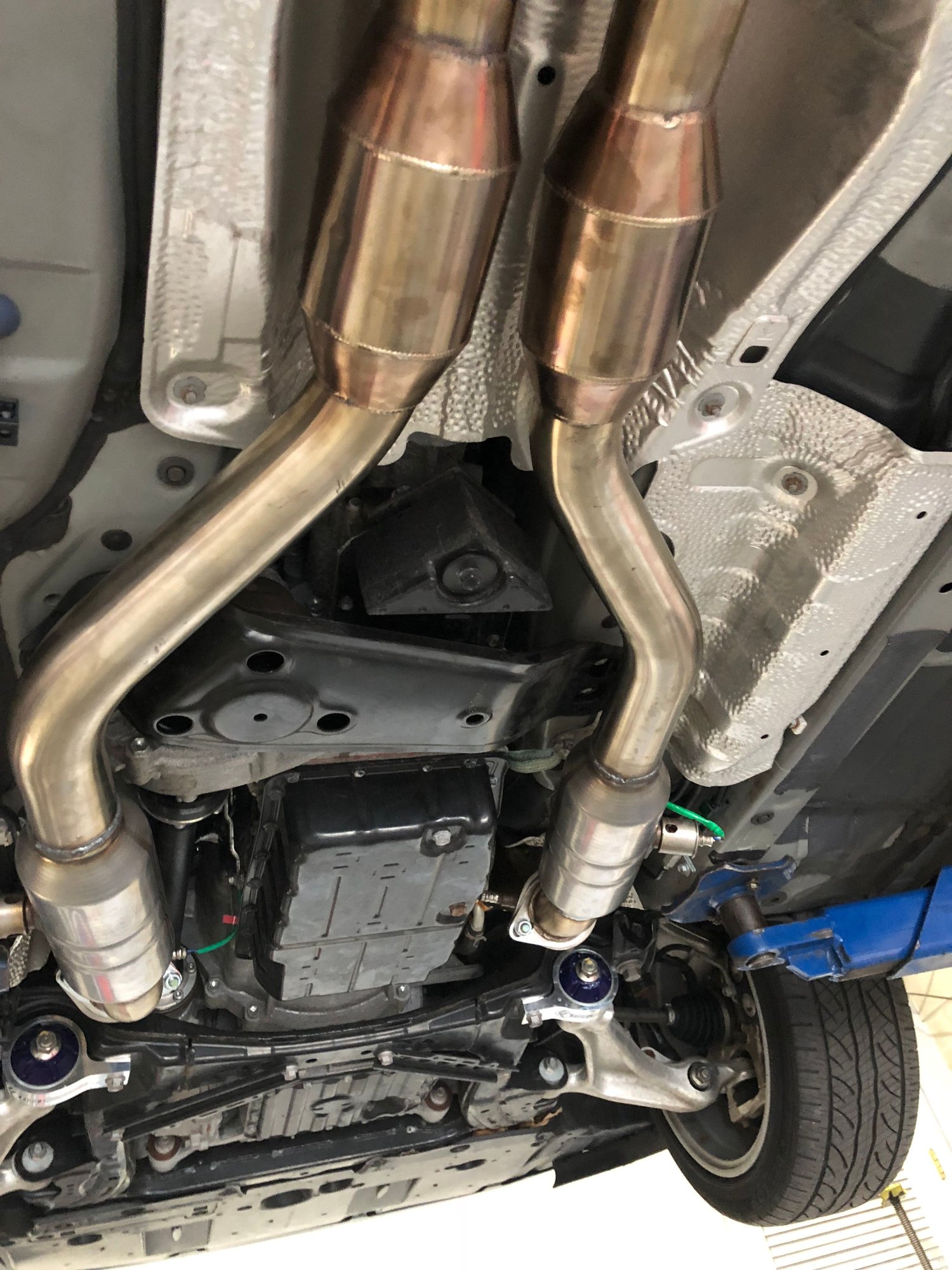

I've tried a couple of axlebacks on my 3IS but it wasn't cutting it for me. Mind you I have PPE headers + Ark mid pipe - makes everything louder and raspier.
1. Full Ark Exhaust - loud as a ****, drone like crazy, raspy, good power gain, sounds great on wot, best looking exhaust for the 3is for the non quad setup.
2. F-sport axle back - little drone, no power gain, not deep enough, raspy on wot, stock look
3. Tanabe medallion - higher drone than #2 but lower than #1, way too deep sound in my opinion, looks like a honda exhaust from the back aesthetic wise, little power gain.
4. Went back to full ark exhaust with modification - bought a couple of Magnaflow cats and had them welded into the full ark exhaust. very little drone now, quiet on idle, nomore rasp, sounds magnificent on wot, retain all the power gain from having a full ark exhaust. looks great from the back.
this ended up being a very expensive experience as you can imagine, i have sold all the other exhaust but with obviously a loss of $. modifying the ark exhaust cost me another 400$ after all was said and done. it was all worth it to me at least now that i have the perfect sound and performance for my car. you gotta pay to play as they all say

Am I correct in assuming that it's the mid-pipe delete/modification/replacement that really makes the car more raspier? I think I've seen that on a few videos.

that is correct, removing the midpipe cats and resonators basically removes anything that slows the air down which is what produces the noise (there's nothing to slow the air down). same with catless headers.
