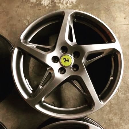

I bought some Ferrari 458 rims yesterday to throw on my Lexus but I don’t know if they’ll fit their 20x8.5 up front and 20x10.5 in the the reaer their also 5x114.3. They line up perfectly, my studs just obviously aren’t long enough. And info or feedback helps. Thanks.

Depends what offset the wheels are.
A 20X8.5 will fit in the front, provided it's a +30 to +35 offset
For the rear, 20X10.5 might fit, but you're gonna need a +45 offset at least.
Of course it sounds like you have another issue with studs that are too short.
Ichiba sells longer ones, I think 55mm...if that's long enough for you.
