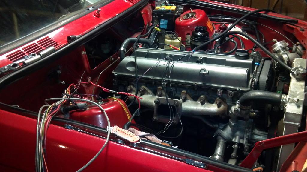

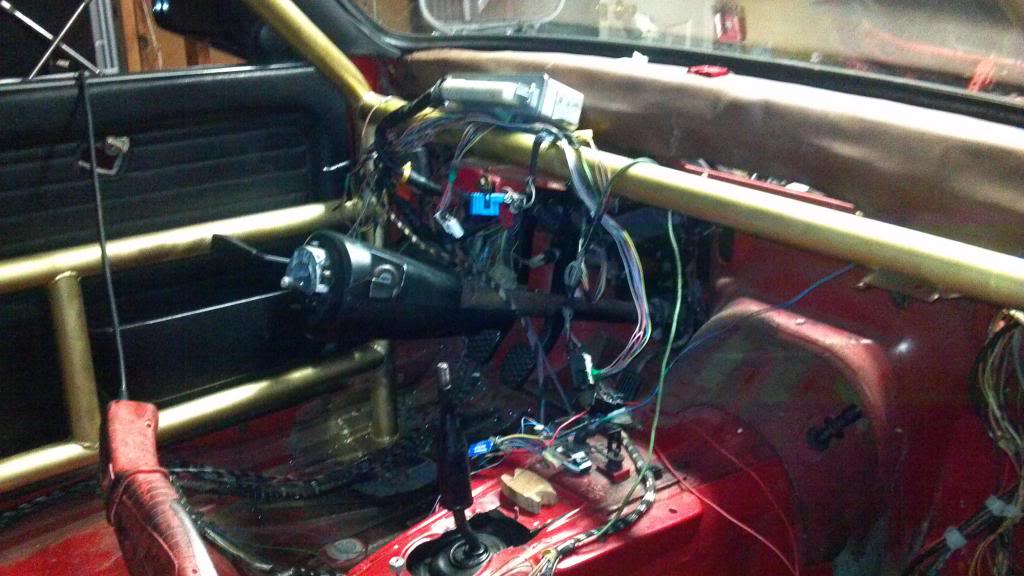

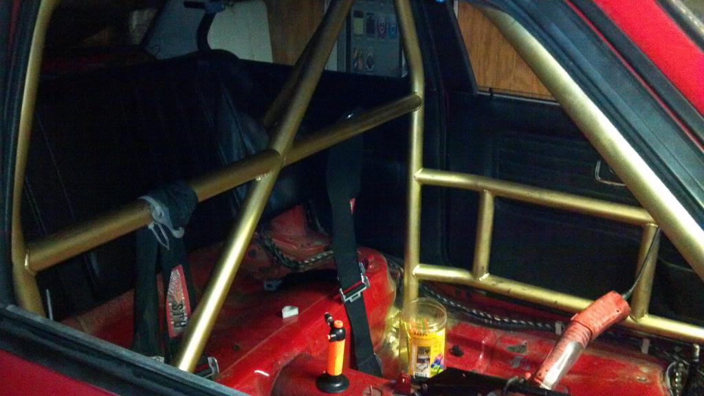

I snapped a few pics of the donor car when I at sleepydubs house. Car is still down but should be ready for a drift event on the 17th of this month. CD009 will go for a stab in this car after the drift event.
Couple pics:
The coil packs and map sensor will be moved to that square compartment behind the engine thats open. That should help with coil heat, apparently hes gonna have the wires come out of one spot of the cover that goes there and straight to the spark plug hole....should be pretty clean.
Tons of wires removed and carpet painted back jet black.
