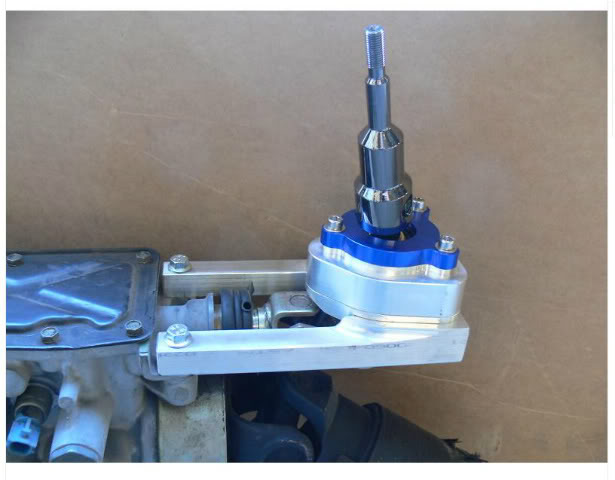

Its all good, basically I took a picture of the shifter that is already sold by someone in tampa fl and put it where it needed to be at 30" and then made the shift linkage come to it. The only difference on the shifter is that I removed the legs and lifted it so it would clear the linkage connection. Collins likes the idea and is going to build mines. IF that shifter works then id imagine we'd be in business on the cd009 concerning hitting the w55's 30" on center mark.
Im really hoping this tranny fits between this lexus cause it sure as hell doesn't look like it will, my friends think it will so we will see.
Same but different..........

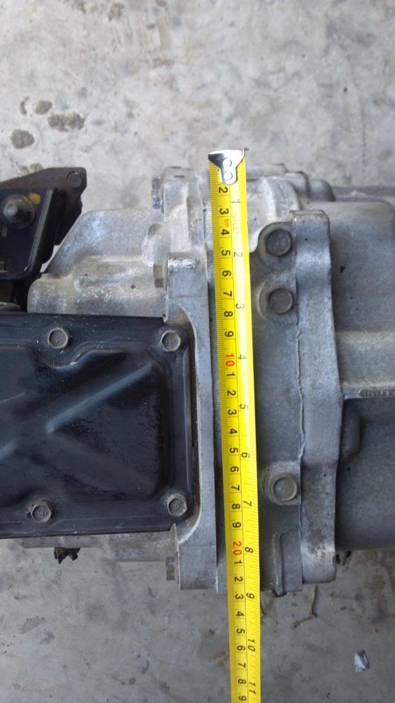

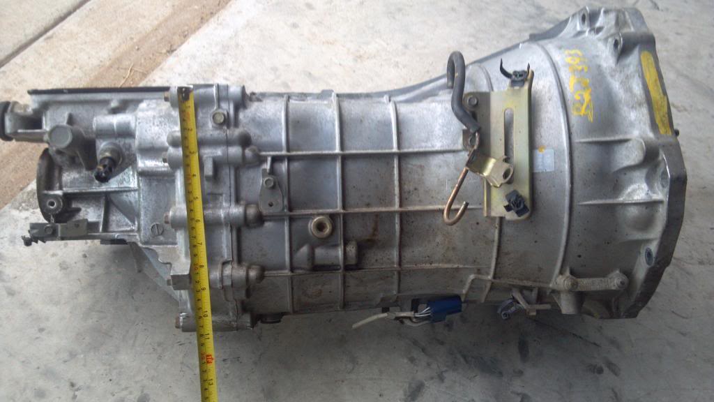

Widest section, starting around 9" eventaually getting to 10" mid ways down.
Measuring right at 11" - 11.5 in this area.
Fit baby fit.

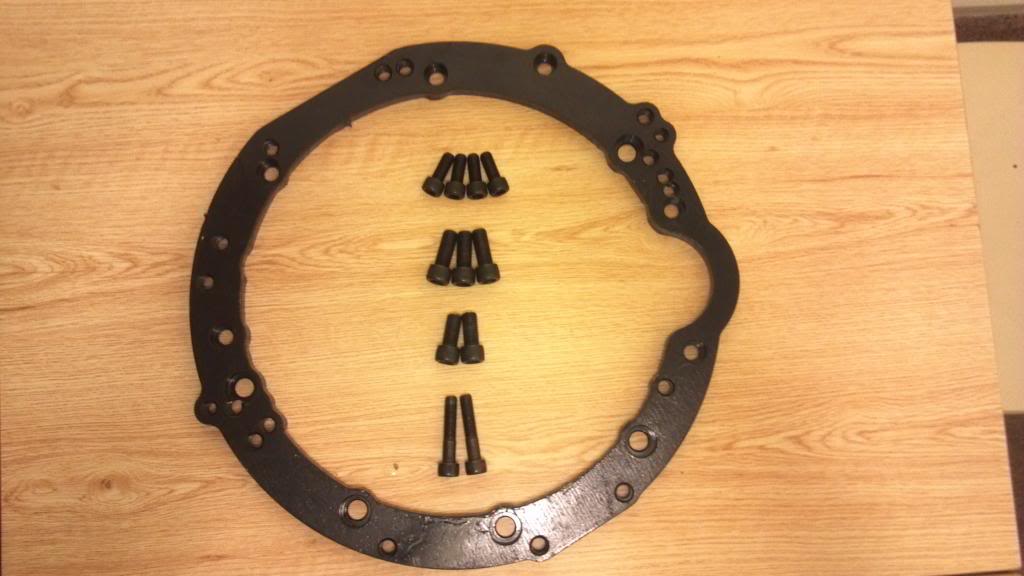

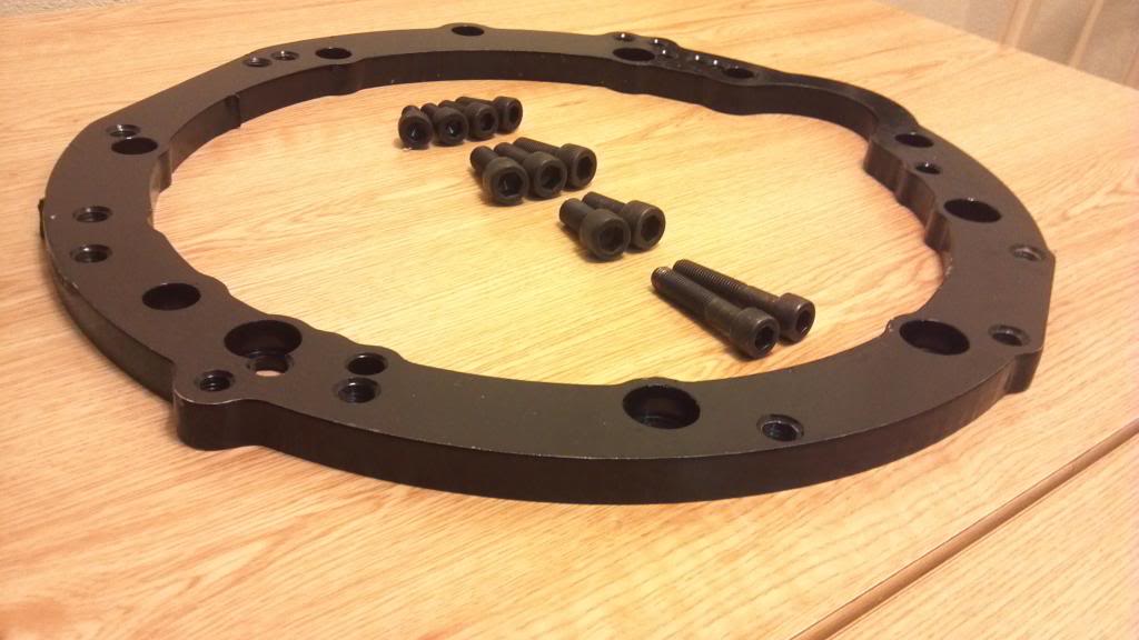

Bracket is in. Looks to be carbon steel with some sort of coating or paint to prevent corrosion and rust. Should be the last thing standing when this car is expired haha. Not sure if I got all the bolts cause the bolt baggy open and box had holes from poor shipping and handling. Either way this should be enough for the fitting so its going down saturday morning.
