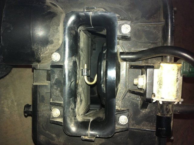

This is exactly the solution that Mazda put it for their 2003+ Mazda6 V6 engines...see these picture to understand how they implemented the "flapper valve" based upon vacuum threshold that was achieved at 3000+ rpm. Till that time, they box would be quiet as a mouse. When it goes over 3000 rpm, the flapper opens up and it is "fun".
Attached Thumbnails Intake box Mod Advice-wioosl.jpg   Intake box Mod Advice-giklbl.jpg

Awesome, thanks for sharing chikoo! Where's the actual flapper that allows the sound to escape?
I have the box at home... Will post pictures in parts tonight....wait for it!
right on, thanks man! Really interested to see how they did it! My valve is super basic though, screw + spring + valve cover
here you go man...see how this works for you.
Attached Thumbnails Intake box Mod Advice-e9kmml.jpg   Intake box Mod Advice-0uod4l.jpg   Intake box Mod Advice-3nr5pl.jpg   Intake box Mod Advice-fxls8l.jpg

Chikoo, thanks for the pics! Not sure i can rig an electric valve, but you just gave me a great idea!
