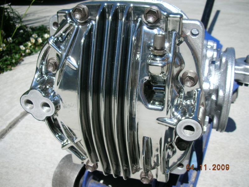

Old Jun 18, 2009 | 06:52 PM
RMMGS4's Avatar
RMMGS4
Northern California Regional Officer
Joined: May 2001
Posts: 8,702
Originally Posted by gs400 civi
wow you had the diff polished, I've never seen that, nice
I could of polished the cover, but I know it will be difficult to keep clean.

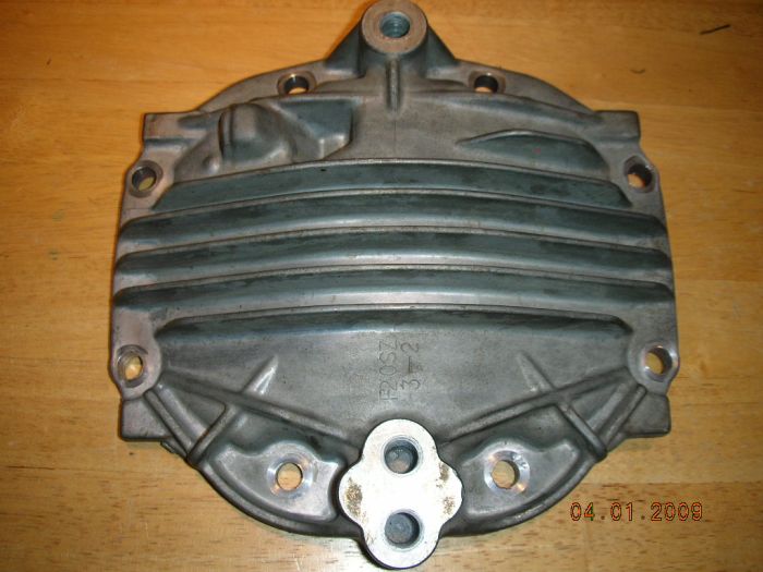

I wanted to try out this new PVD process offered by www.SIKIndustries.com. It's not chrome plating, but it has the durability and shine of chrome. It's not chemical dipped and it's not chrome colored paint.
The PVD process or Physical Vapor Deposition, can be used on non-porous materials like plastic to provide a chrome like finish without the chemical dipping. What would be difficult with chroming the differential cover is trying to get a smooth shiny finish inside all the nooks and crannies.
Here's what the cover looked like before I had it done.
