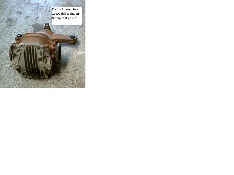

Im about to go get my 3.76 installed and i was wondering if there's anything i should know before the install? I know i need 75w90 gear oil. but about the actual install..
i've already looked at bananaGs's website, and i've seen jeffsai's link, is there any more info? i've heard that you have to change the back cover from the Gs 400 diff and swap it with the supra unit. because of the holes.. how supra has 2 and gs has 3, The guy from carson didn't really know either.

If you have a GS400, then it should be a direct swap. It's only the GS300s that needs to be modified.

They all have 3 holes on all...doesn't matter if Supra/GS3/4. It will bolt right up to all. Only difference is that the GS300 needs to swap the flange that goes to the driveshaft.
I diy'ed this and didn't change a thing from the Supra rear end! Bolts right up. Just make sure you have the right tools......read the DIY again. The 14MM hex socket(I think this is the size but could be wrong......pulling from memory) was a little hard to find in Atlanta.
