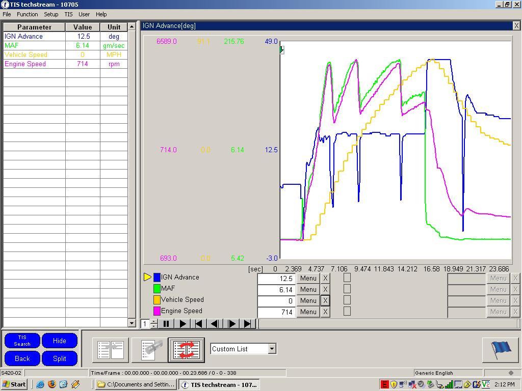

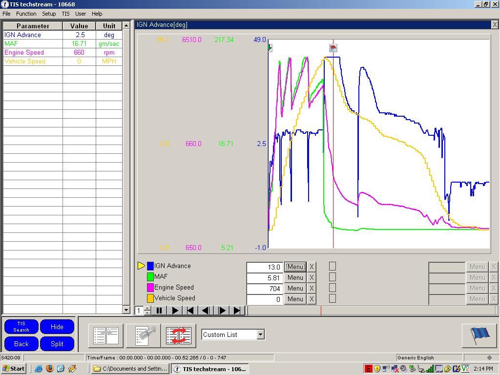

Latest Update
It has taken us a while to get the latest update but here it is.
The two items me and Troy (combfilter) were concerned about were the MAF meter output increase and the engine's ignition timing.
The cars compared were both our cars. We found a road in Mexico ( ) with no traffic and did a few pulls to about 90 MPH. The data was scanned with the Lexus Techstream and then graphed.
Stats on both cars:
I have an 08 IS350 with the only power upgrade is a Lexus HKS exhuast. I've dynoed the car at ATSracing in Denton,TX and the vehicle did 270,269 and 271 peak RWHP on three runs on their Dynojet at the DFWsupra may meet.
Troy's car has the JoeZ intake tube with a removed charcoal filter and a free flowing filter. The throttle body gasket has had the screen deleted also. The exhaust is a Borla offroad and the vehicle dynoed 280 peak RWHP before the headers were installed. After the headers the vehicle did 276.
My car peaked the MAF meter at 215.76 gm/sec and his did 217.34 gm/sec. Just to give you guys an idea of what these numbers mean, at idle both cars did ~3.5 gm/sec in park and ~6 gm/sec in drive. So ~2 gm/sec is almost insignificant as though it were to compare a spit in the ocean.
Also both cars did 28 deg of ignition timing advance. So the engine ecu wasn't holding any power from the header install.
The 250 and 350's exhaust systems are virtually identical so the power gains in the 250 with the header install got me scratching my head. Obviously something else is the restriction on the 350 and it is either the intake manifold or the head/cams. And both of which haven't had an aftermarket performance offering yet on the market and are different on both the 250 and 350.
Here are the graphs for my IS350 and Troy's IS350
