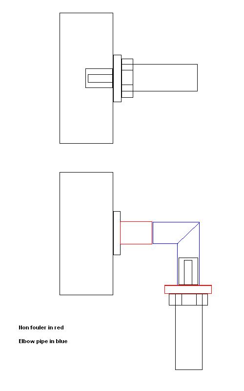

The code we recieved after the sims were installed on Troy's car was a p0606 ecm/pcm processor malfunction. It is a hard code and coes on instantly. The code comes on when it sees either both A/F sensors disconnected or both HO2 sensors disconnected. The HO2 sensors are the secondary sensors. They monitor the convertor's performance. Thats their only function. They will not change the behaviour of the ecu or how it controls the engine. They can be divided in two circuits. The heater circuit and the sensor circuit. The heater circuit is powered by the circuit open relay. The ecm provides a controlled ground to control the current required to warmup and maintain heat on the HO2 sensor's heating element. The sensor circuit have a sensor signal and sensor ground both of which are provided by the ecm. Since Troy's IS350 have this code come on during startup, there is a possibility that the code is from the ecm performing a sensor circuit inspection by measuring the continuity, resistance, or current accross these two leads. If the sensors were disconnected (as in the case of the sims being wired in) there won't be any continuity from the signals leads to the ground leads.
I did notice that even with the check engine light on, and the sims installed, the datalist was showing the normal waveform of the secondary sensors. So the ecm should've been happy with the result.
The vehicle drives normal and this is the only minor setback we are currently experiencing. I'm planning on using smoe non-foulers (as someone had suggested above) The sensors with the non-foulers installed would create clearance issues. I plan on making a 90 deg bend with a pipe and weld it to the middle on the non-fouler.
I made an image of what I'm trying to say down below.
