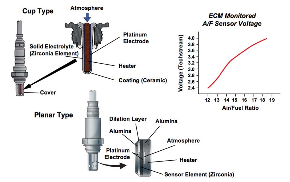

I've gotten some data pertaining to the AF sensors. They work from 0-5 volts unlike the 1-volt Heated O2 sensors. I need to find the A/F to AF voltage table. I'm planning on logging my IS350 to see the difference between both vehicles. I'm also planning on reviewing the logs for the A/F, injector duty cycle, fuel trims, MAF flow, and comparing both vehicles to see where we stand with the vehicles currently. Then after the Mazzuri headers go in we can review the change it has made. Being that Troy's car is performing excellent so far, I'm predicting some promising gains. We keep you guys posted with a few graphs once we get them handled.
-Joe
More detailed than this:

Yeah, I found it. Its this one.
