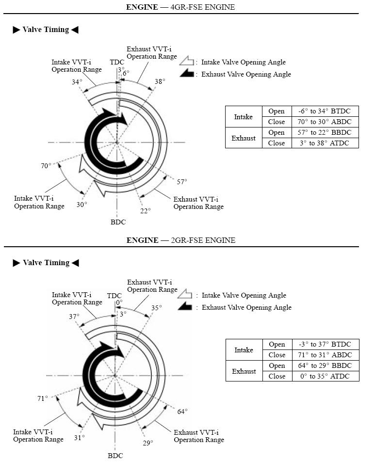

Here's everything Toyota will tell you about the 2GR and 4GR:
As you can see, there isn't much to work with here. It's very unlikely stuffing different cams in the engine will result in much. It might be more valuable to swap both cams and cam drive components since VVTi is going to attempt to thwart any change you make because the ECM is keenly aware when you've changed cams.
Should you choose this path, don't assume it will be all good. In all likelihood, it will not be good at all.

What would you like to bet the cams are identical and only the sprockets are different to allow the phasing to be different (note the duration of both engines is the same, but the lobe centers are 3 degrees different on the intake and 7 degrees on the exhaust.)
