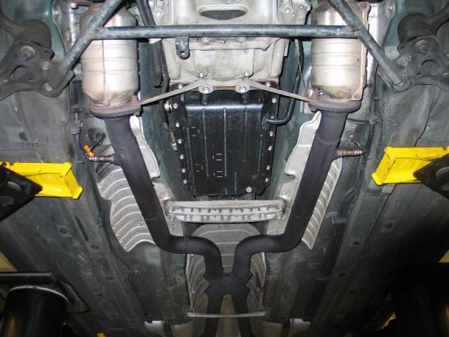

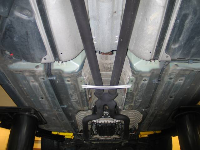

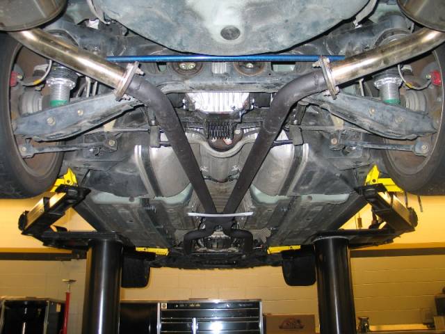

O.K. I've actually had the drivers side header back for about a month now. The passenger side even longer. Thanks to Loren for taking care of us. He sent me new ones on both sides with a fresh coat of Jet Hot. I know this is so, because I had to redrill the holes on the header flange that mates to the exhaust ports on the heads. Also had to shave metal off the opening on the flange to clear the lip on the cats where the gasket sits.
Anyway, I finally had the opportunity to reinstall them on the car this past Sunday, Feb. 25th. Much easier without the heat shields. Did not even have to drop the subframe/crossmember. Like I said, I love this mod. Well worth the money spent. Much better throttle response. The car now has more rumble to it than before. Coupled to the custom X pipe, it sounds even better with a more exotic rumble to it. Sorry guys, I don't have any sound clips or video. I should get on it soon though.
Her are some pics prior to installation and I also included some of the X pipe.
Enjoy!
Before repairs. Drivers side.
After repairs. Driver side. You could see where they added more welds.
Driver side and passenger side. (New and improved)
Pics of the X pipe.
