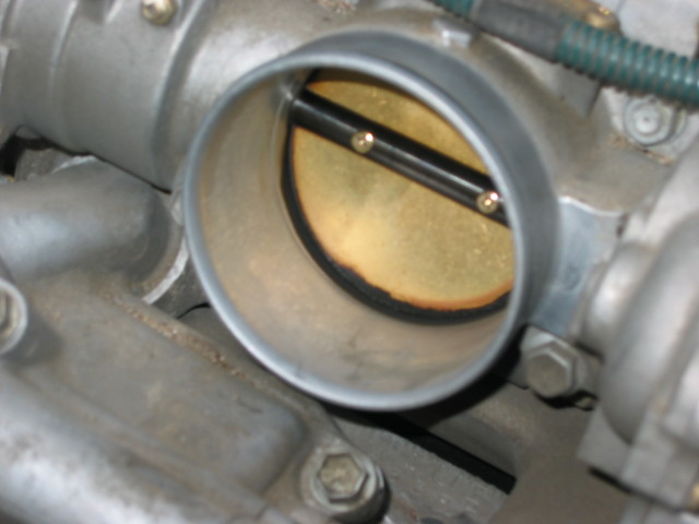

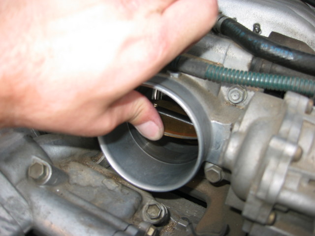

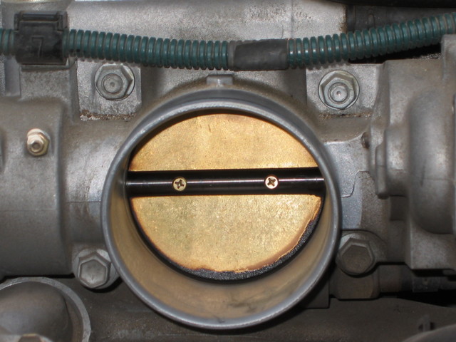

On the way home from work today I decided to pick up some throttle body cleaner and clean her up. I have 90k on my 98 GS4 and it looks like the throttle body has never been cleaned. I also cleaned the MAF sensor and my K&N filter recently. Hell it feels more responsive and runs better than when I had an intake on there. It's like a $2.99 mod! If you have higher mileage and haven't done this get off your butt and do it! I hooked the battery back up and started it up and it ran at higher rpms (1000) for about 5-10 mins. Then it settled down and is really smooth. It was really full of carbon build up and I only use Amoco 93 octane.
it's dirty in there
the remains of the battle
ahh so clean

I was worried about spraying it in there so I just sprayed cleaner on the rag and wiped it clean. A lot of the crap on the inside was cooked on so I used a toothbrush to scrub .
