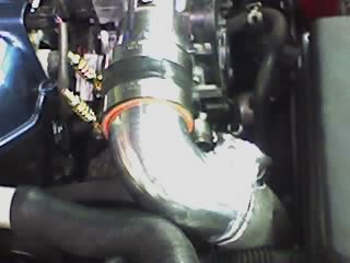

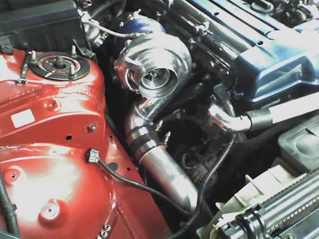

Thanks Bluelex. I'm only about 25 minutes from JM Lexus. Keep me in mind when the meet gets close. I must say my car doesn't come anywhere close to how bad__s your car is, but give me time ......and money and hopefully I will be there. Once the engine is in and running, I'll work on the outside. Well we piped the cold and hot side yesterday, still needs to be polished. Only had to cut some plastic undersiding. Very minor cutting. The stock bumper needs very minor cutting as well. That will be gone soon. VERTEX KIT. We also did the downpipe and part of the exhaust, all stainless steel. I have to drill the hole and get the Supra O2 sensor. We also took out the fuel pump, we are gonna run a dash 8 or 10 up to the engine and split it for now. That way when I upgrade the fuel rail and everything, I don't have to waste money. Also a return line. Here's a few pics, should be done and off to get wired on Monday.

Hot side piping
