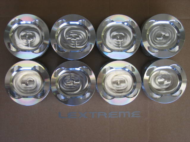

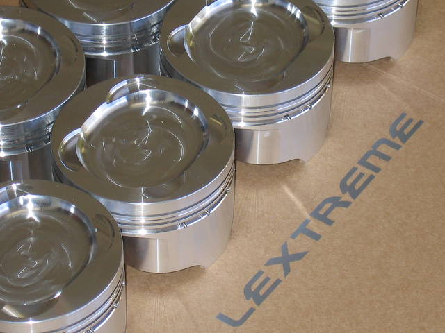

First, big shot out to lextreme for his help in this project. My main goal was to safley up the HP for my 2001 GS430. I lowered the compression to 9:1 with Ross forged pistons, went with the 1uz rods (much stronger), all new gaskets, and ARP studs. I plan to be pushing 10-12 lbs. of boost. I want to stay with stock ecu/injectors. I do not know right now what the max amount of boost I can go with the stock injectors. I am currently in the process of just braking the motor in. Here are some pictures I wanted to share with you guys

Now that is a PURDY sight.
Man, those small rods...I can't believe those just don't snap at the slightest things. Those things aren't even straight. I is like a toothpick with a big and small end. Yikes.

Could you have stroked it to 4.7 L????
