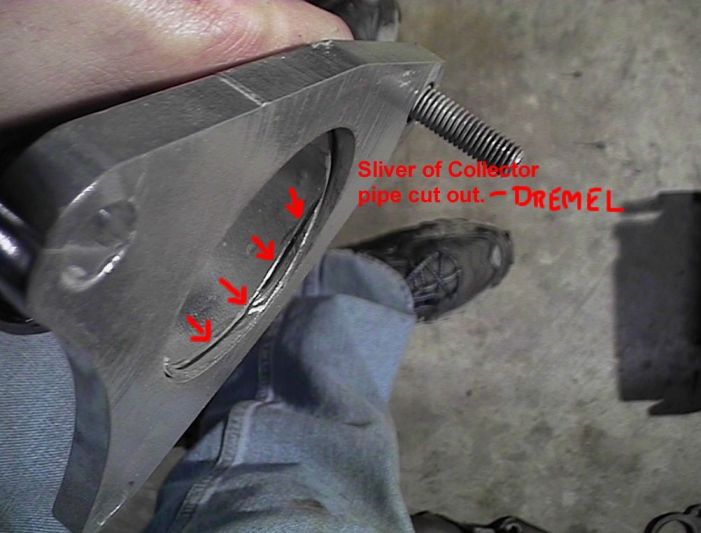

Old Nov 28, 2005 | 03:37 PM
BA_GS400's Avatar
BA_GS400
Joined: May 2004
Posts: 806
Default Modified Header
Modified Header

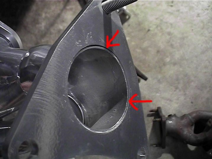

Old Nov 28, 2005 | 03:38 PM
BA_GS400's Avatar
BA_GS400
Joined: May 2004
Posts: 806
Default Modified Header 2
Modified Header 2

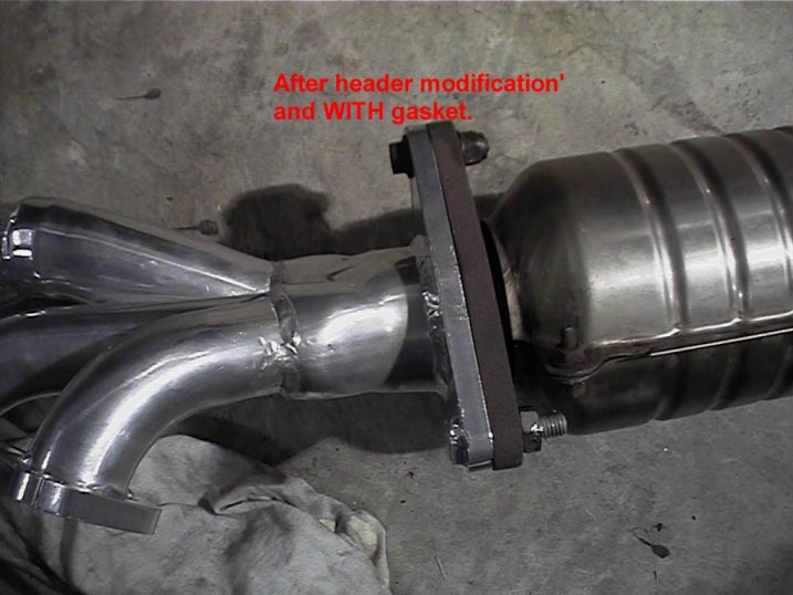

Old Nov 28, 2005 | 03:42 PM
BA_GS400's Avatar
BA_GS400
Joined: May 2004
Posts: 806
Default modified header and catalytic 2
Attached Thumbnails Header Install HELP-13-gs400-header-to-catalytic-w-gasket.jpg

Posts: 806
Some of you might be thinking "wow, he went the hard route" and you are probably right.
I could have done any of the things JB mentioned earlier but this is the route I wanted to take. I think it's more like the factory design, I get to use the factory copper gasket instead of some aftermarket gasket, and I think I'm *more* assured of a leak-free fitment. For me, it was worth the time.
The absolutely quickest fix would have been to do what I think TRBOPOOH (or someone) did and grind down the little tube coming out of the catalytic convertor.
