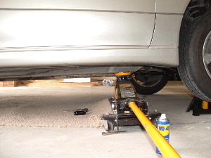

1) Locate sensor (this one is for the Bank 2 Sensor 2)
2) Raise car - i used a floor jack and lifted up the front passenger side and put a stand under the front suspension just in case the jack fell.
3) Spray some lubricant around connection of sensor, I used WD-40, to help loosen.
4) Using the oxygen sensor removal socket I then loosened the bad sensor and removed it completely from original position.

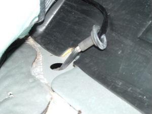

Pic 1 is the oxygen sensor removal tool.
Pic 2 is the location of sensor under car
Pic 3 is the location of sensor under car close up
Pic 4 is the location inside car under passenger side carpet
Pic 5 is the location inside car under passenger side carpet close up
Pic 6 is the wire harness connection close up
Pic 7 is sensor wrapped in tape.

Old Nov 26, 2004 | 02:03 PM
bvance's Avatar
bvance
Joined: Apr 2004
Posts: 27
Default Pic2
Havent figured out how to post mult. pics. sorry

Old Nov 26, 2004 | 02:06 PM
bvance's Avatar
bvance
Joined: Apr 2004
Posts: 27
Default Pic 5
Pic 5
