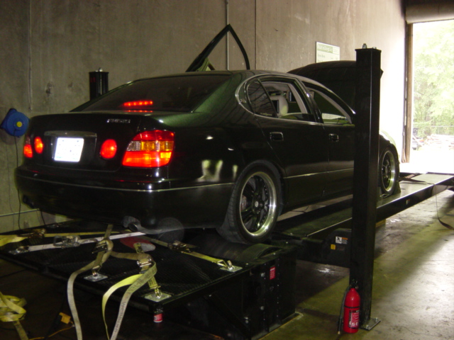

Guys, just spoke to John and he's working diligently to get those charts up today. Until then, here are some quick pics.

You have lambo style doors on your car, gawd?
Actually, that's Halo's car with the lambo doors. He and TXGS were kind enough to accompany me to the dyno so we could get additional info on the cars.
