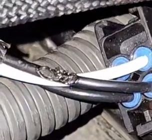

I was previously getting a P0031 and P0051 that would pop right back up immediately after clearing codes. I found out the bank1 O2 extension melted, I'm assuming from the exhaust manifold. I got rid of the melted extension and replaced the 15amp A/F fuse. And now I have Long/Short term fuel trims working again.(previously constantly displayed "0") And had no cel for 2 days.

I noticed the O2 extender was burned/melted where the wire was exposed near the end past the protection sleeve, so I took the extenders out and replaced the blown 15amp fuse. Next time I drove the car and checked the data, O2 sensors were back and car drove smooth.
