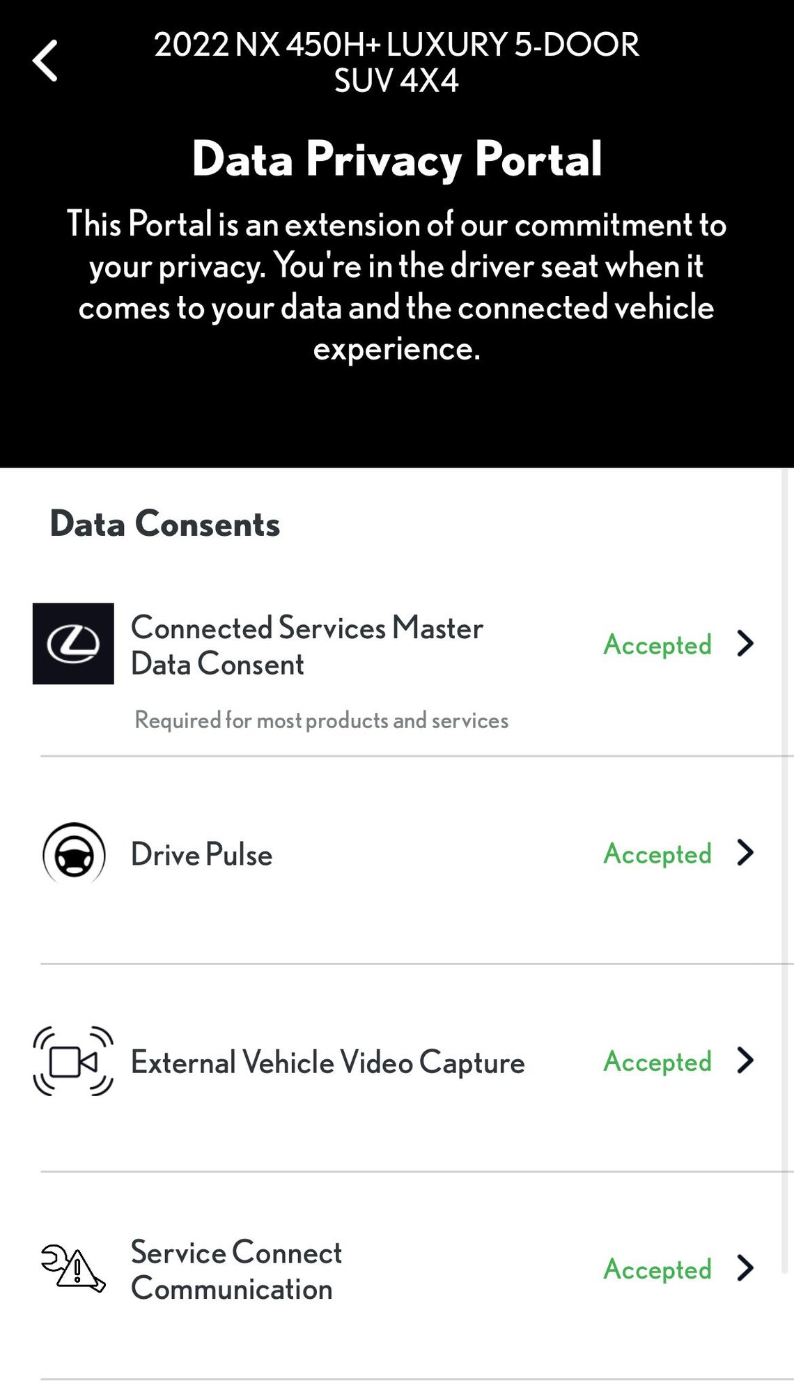

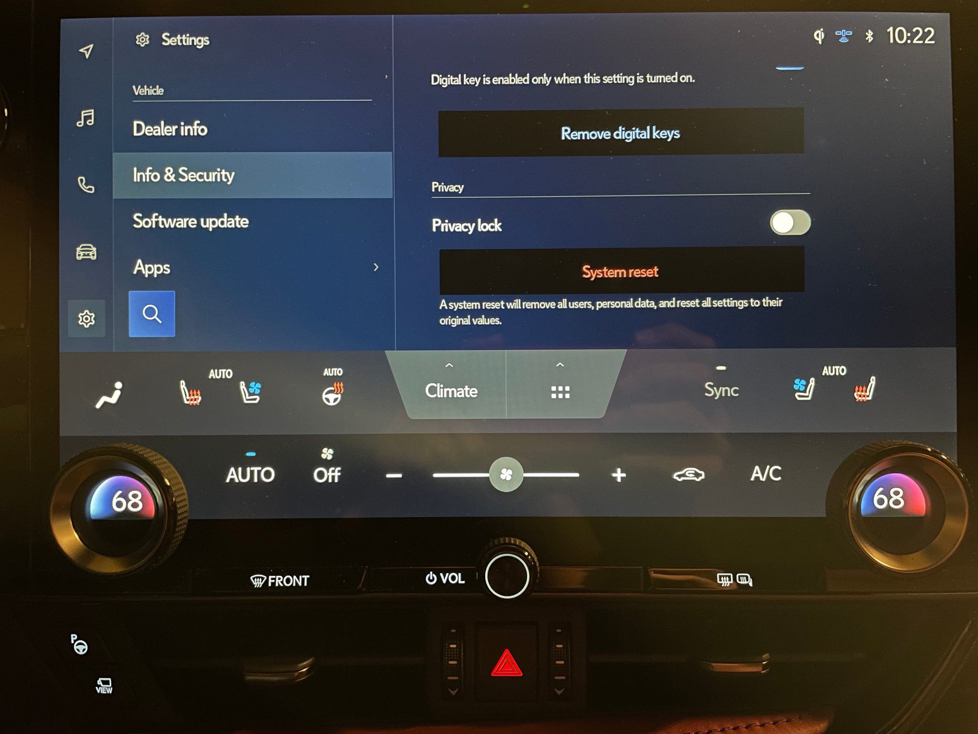

FYI, I was having trouble with Digital Key - in addition I did not have Recent Trips or Drive Pulse populating in the new iPhone nor the old iPhone app. I also only had the ability to change the temperature in climate, none of the other features were available to me.
This past weekend I did a system reset (on the infotainment screen) removing me from the car entirely, removed all bluetooth connections on the phone, deleted the app from my phone and reboot everything... then started from scratch - after doing this, absolutely everything above was resolved. What is new to me, under my account, data privacy portal, there is NOW a "Drive Pulse" acceptance - which I never had before on the old or new app - it wasn't an option.
I am not sure why everything is fixed this time around, I had done a system reset about a week after getting the car under the old iPhone app and the issues still persisted (tho digital key issues I had back then were fixed) something I read out there was to turn off “ACC Customize,” no idea what this does, but perhaps this system reset with that ACC setting off this time around had something to do with why everything now seems to be working?
