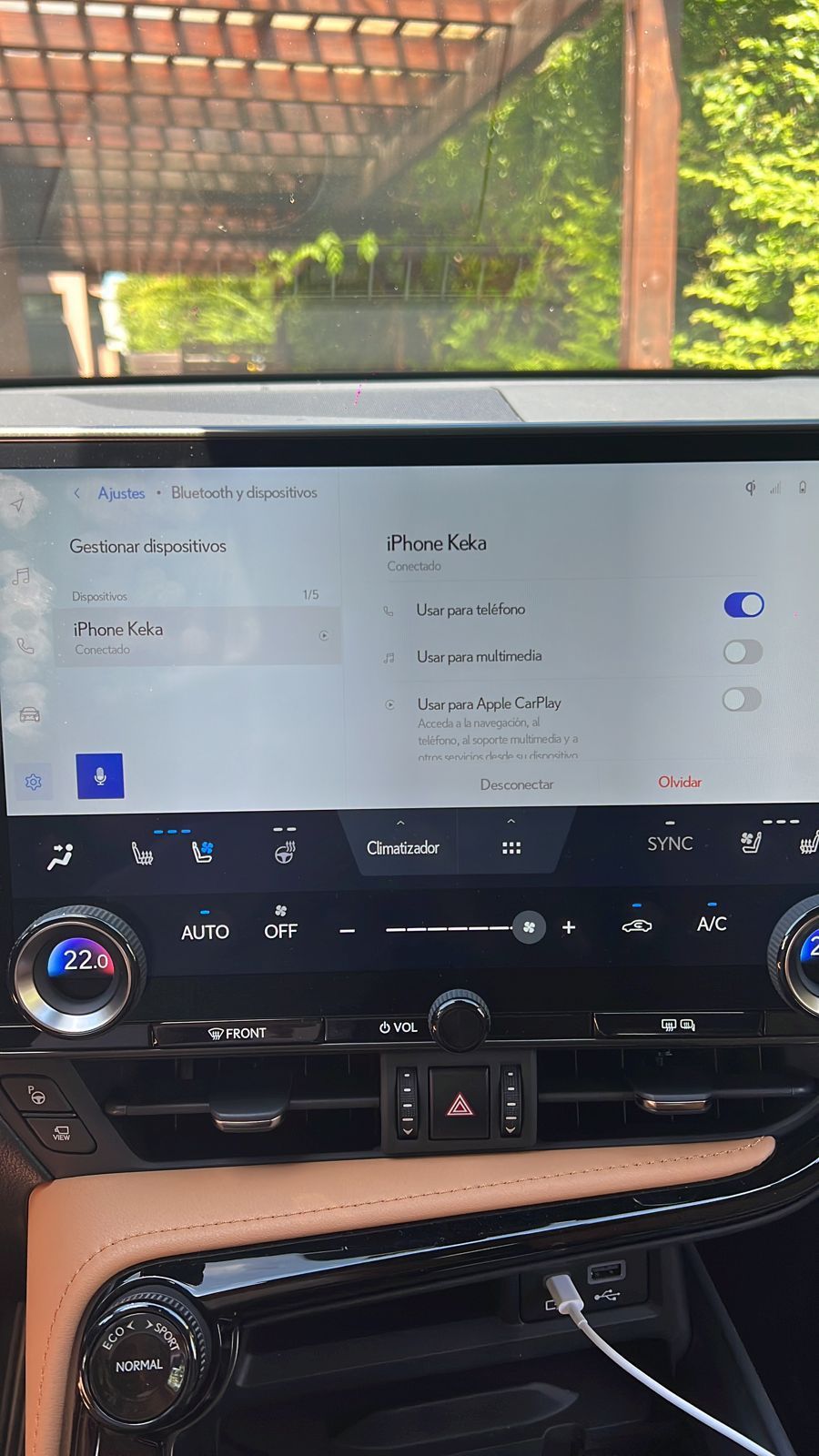

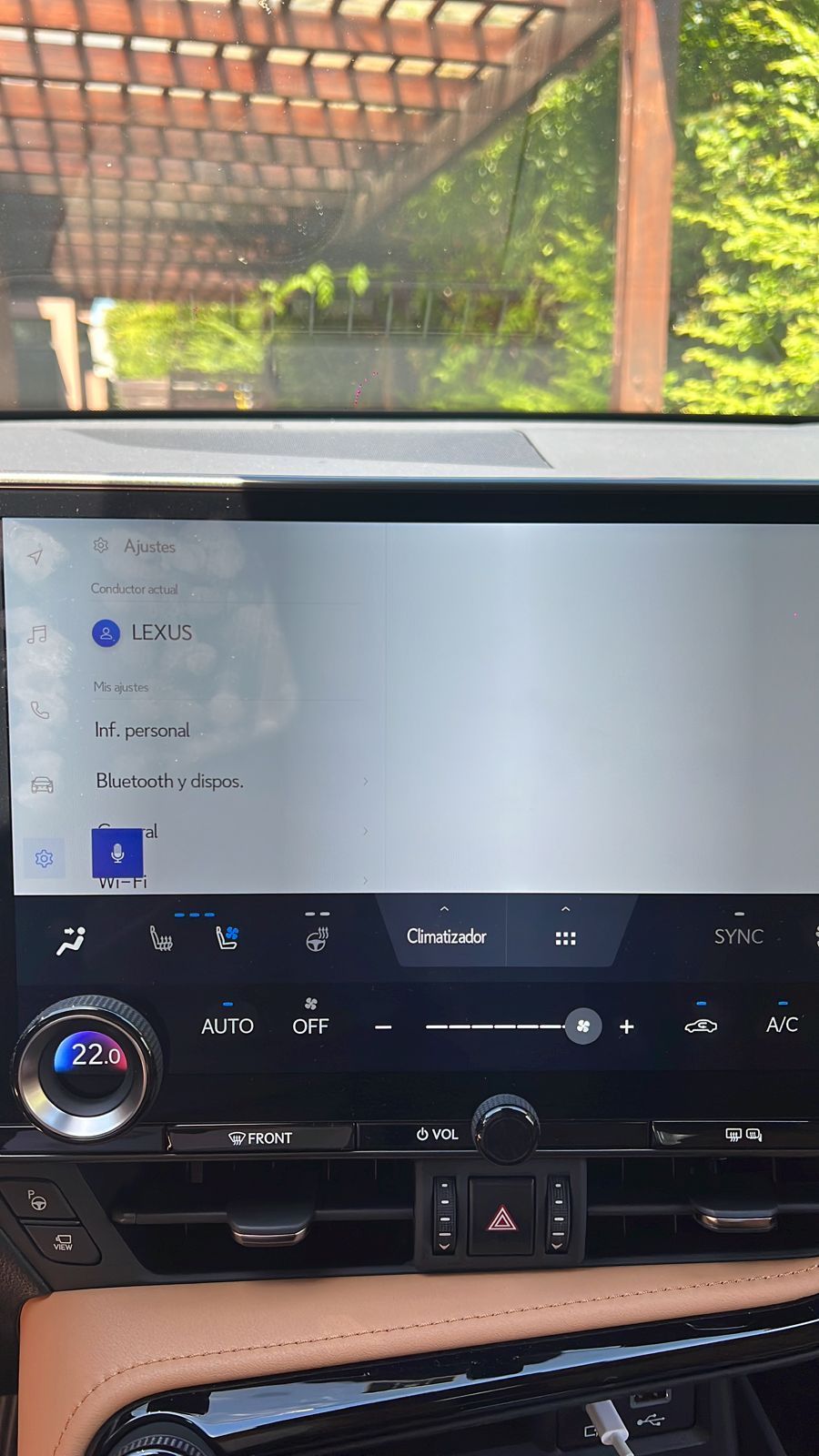

Hello, I am knew here in the forum and I have a new Nx350 2022, I got the car two weeks ago and noticed right away this delay in my calls while using car play with my IPhone 13. I called the dealership i they told me they were aware of the problem and that they were waiting for a patch to solve it.
Well let me tell you that I solve the problem partially jajaja, I tried something going through the settings of the car, and it working ok. At least I can use the Bluetooth properly and with out delay. What I did is disconnect the use of car play with my phone while connecting it to the Lexus Bluetooth. You have go to settings and access the Bluetooth menu, there you will see your phone as connected, click on your phone on the Lexus screen, you will notice you can select to use your phone for CarPlay or not, well deselect that option, just select to use it as a phone and to use it for multimedia. It’s way you would be using your phone with the old Lexus Bluetooth traditional system. Clearly the problem seems to be with CarPlay, the Bluetooth seems to work perfect. Until the Lexus tech guys find a real solution we will have to use Waze or Spotify the old fashion way.
I have attached some photos to guide you through, unfortunately my car settings are in Spanish, but I hope my explanations helps you. It’s insane nobody at Lexus came up with this partial solution before. In fact, I am going to call my Argentine dealership to let them know!! Hahah.
cheers,
Juan
