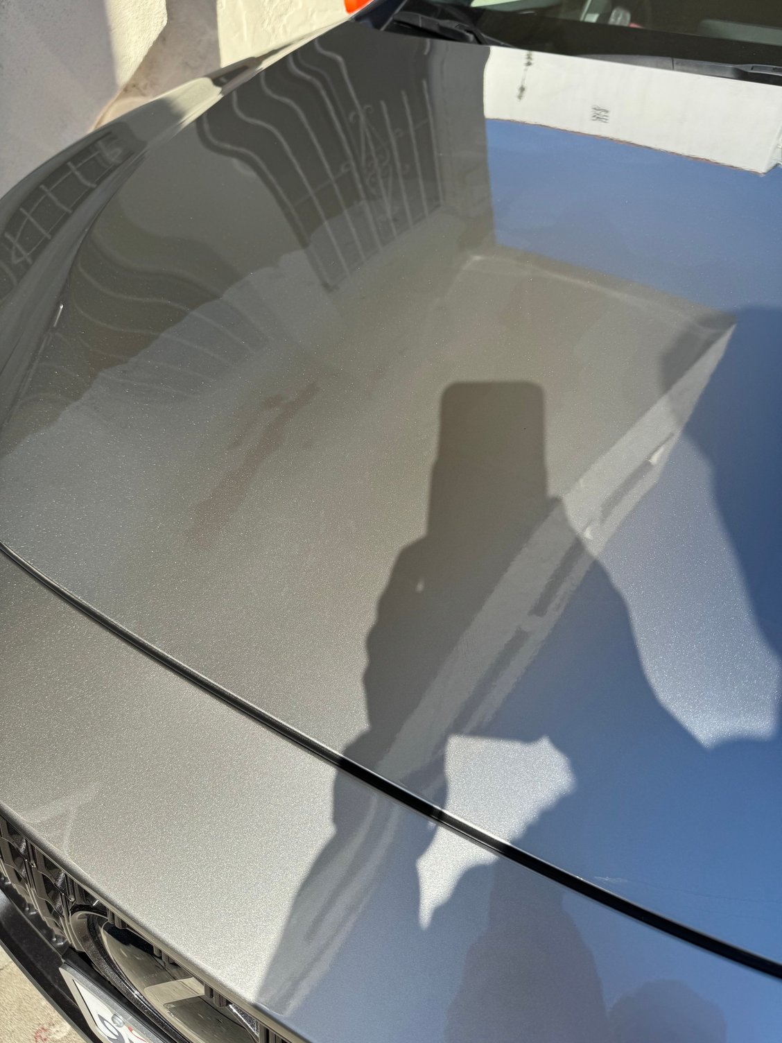

I recently left my Lexus for a couple weeks during a bad rain.. I had a nice cover, I thought,
over it, but when I came back and lifted the cover, water had leaked underneath. And now I have these stains on my hood. How do I get these off?
UPDATE 1/14/26

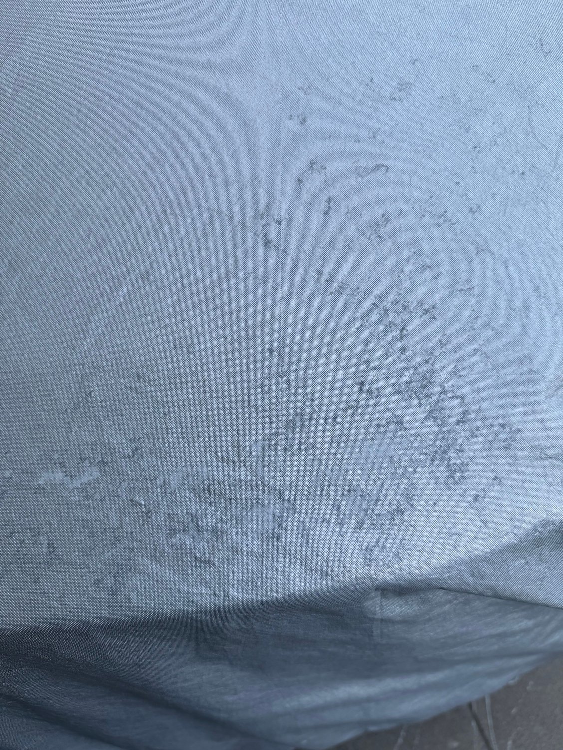

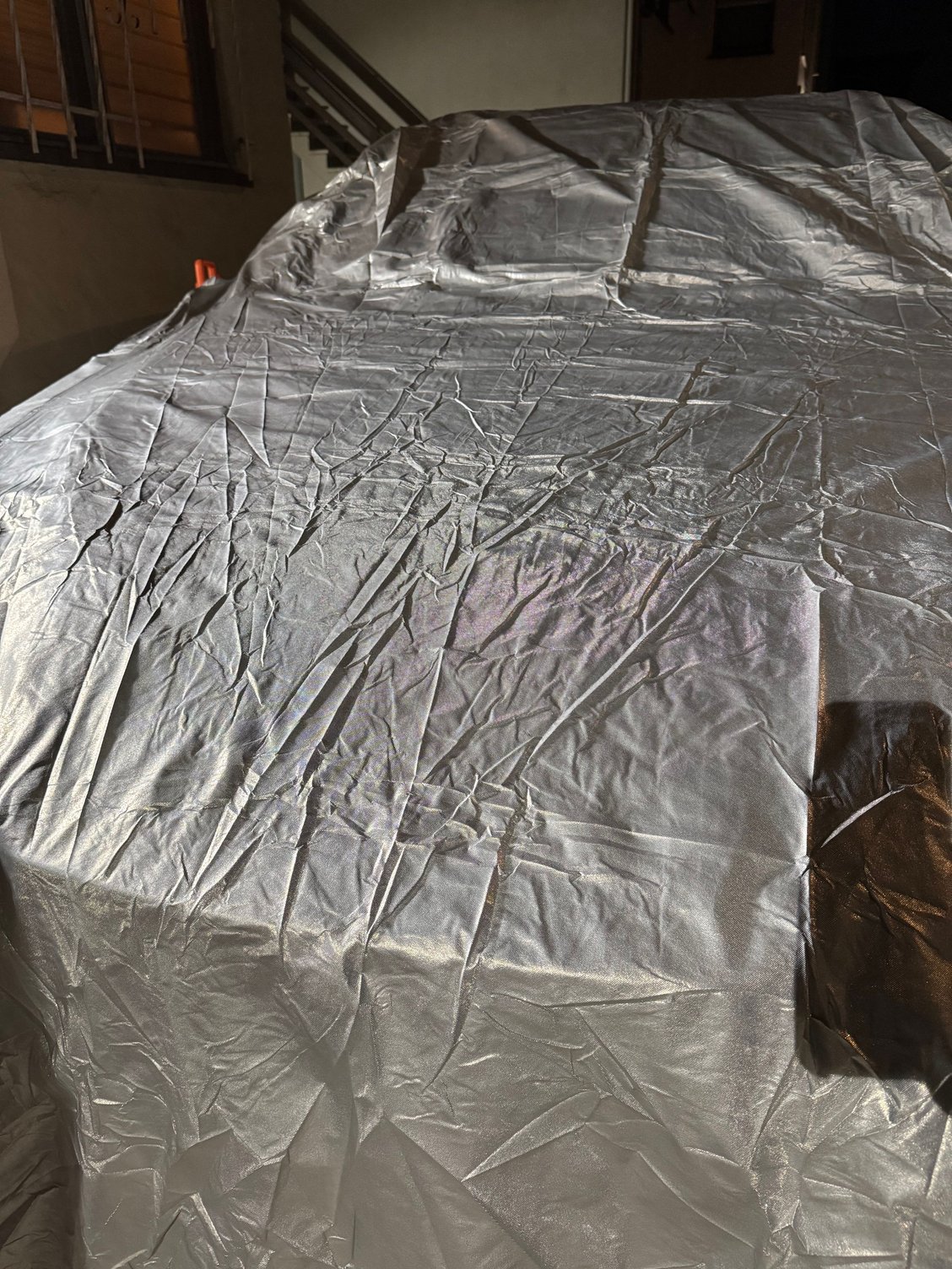

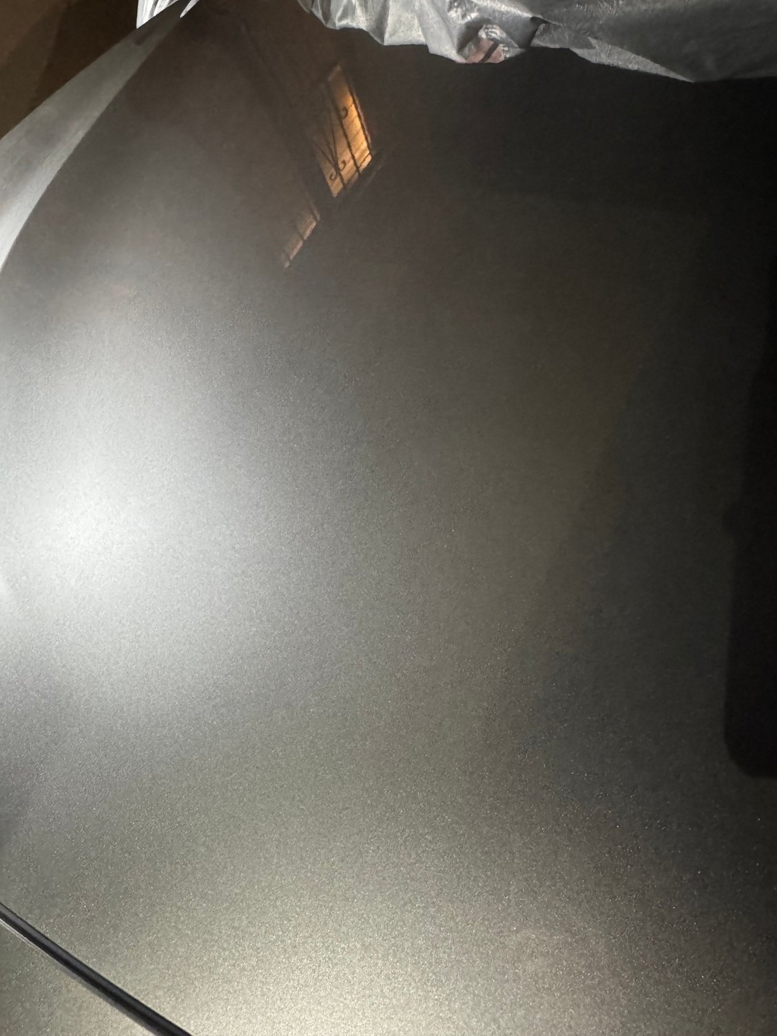

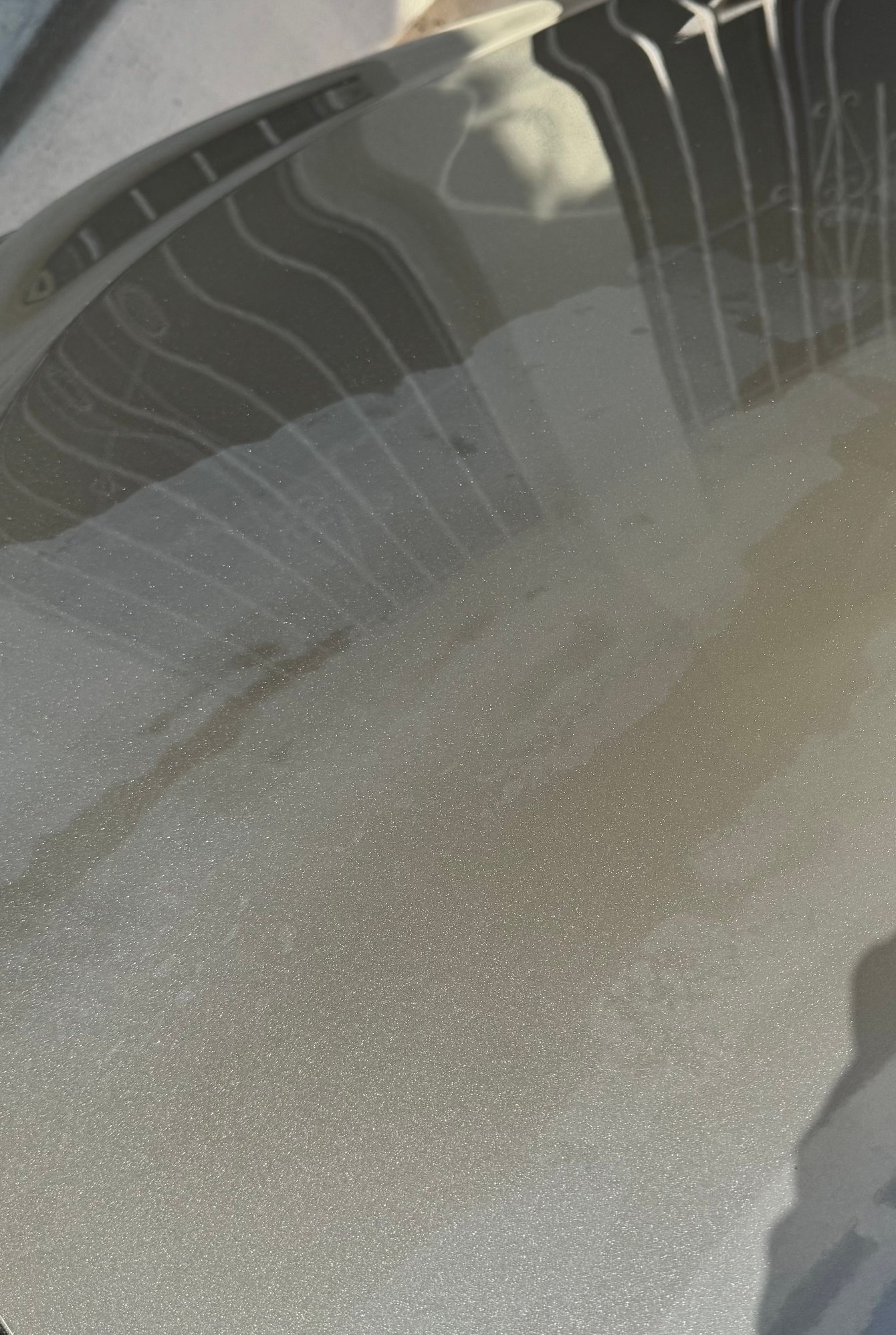

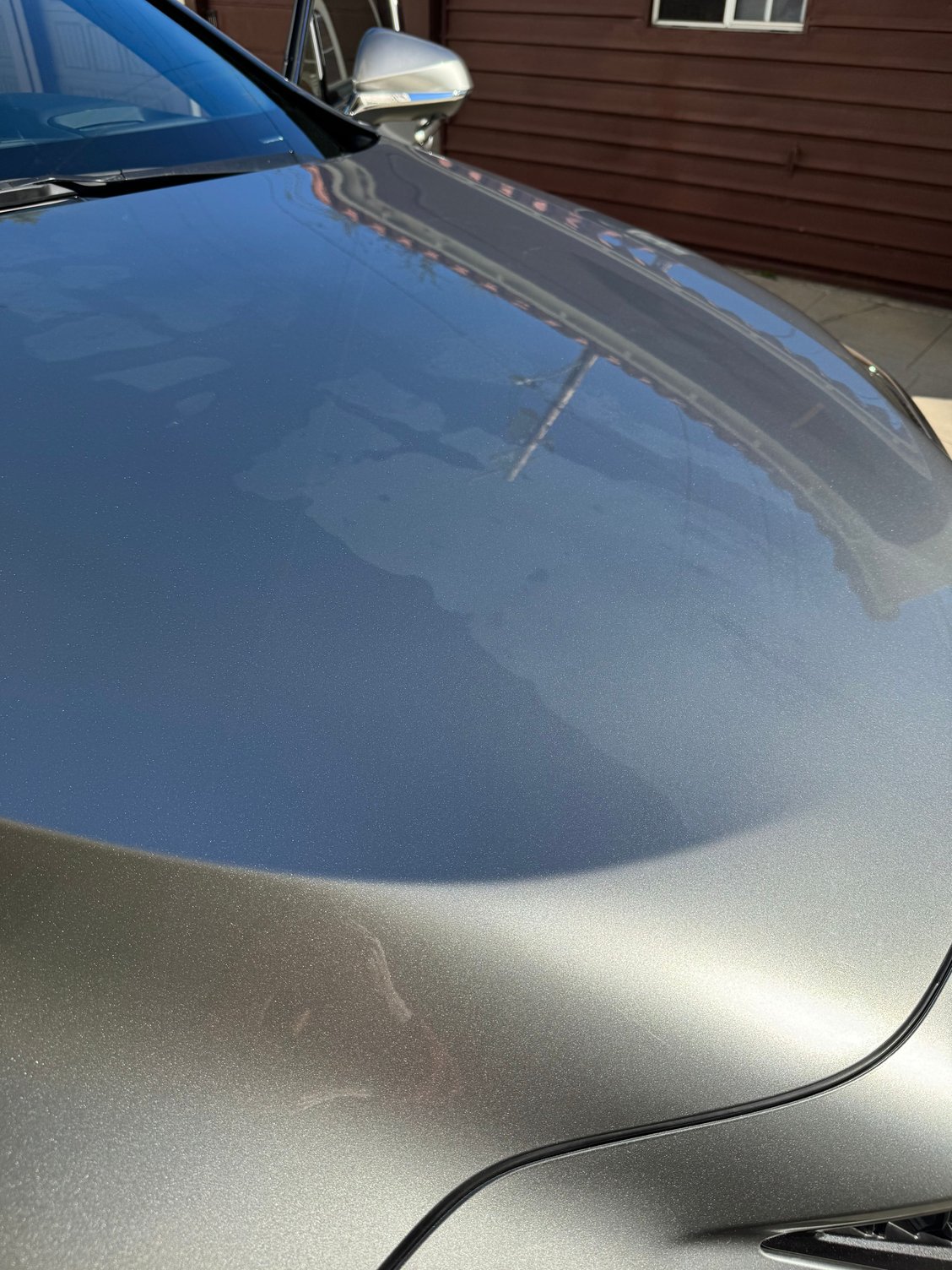

So happy to report that there is a not a single trace of a stain left! Leaving it in the sun over the past week slowly got rid of all of the white blotches. The new cover arrived and it definitely looks and feels much different than my old one. I guess they have a shelf life of less than two years. I don’t think that the material is different so much as it just got old baking under the sun. So I’m just gonna run with this cover and keep an eye on it after about a year and a half. And I won’t be leaving it on if I’m going to be away during a rainy period. Also, the chemical guys rain spot remover arrived, and I realized that is actually for addressing water spots that leave a residue on top of the paint. The problem I had was that the water was INSIDE the paint. It didn’t have any residue on the surface that you can dissolve or scrape away. It just made the actual paint milky white. So I didn’t use it. I guess the only alternative if you
don’t have sun to do the healing is maybe a hairdryer? But just so glad I don’t have to repaint the hood!

I do believe that your water stains/issues were in or underneath your clear Top Coat that made the white blotches on top of your paint and not in your actual paint color.
