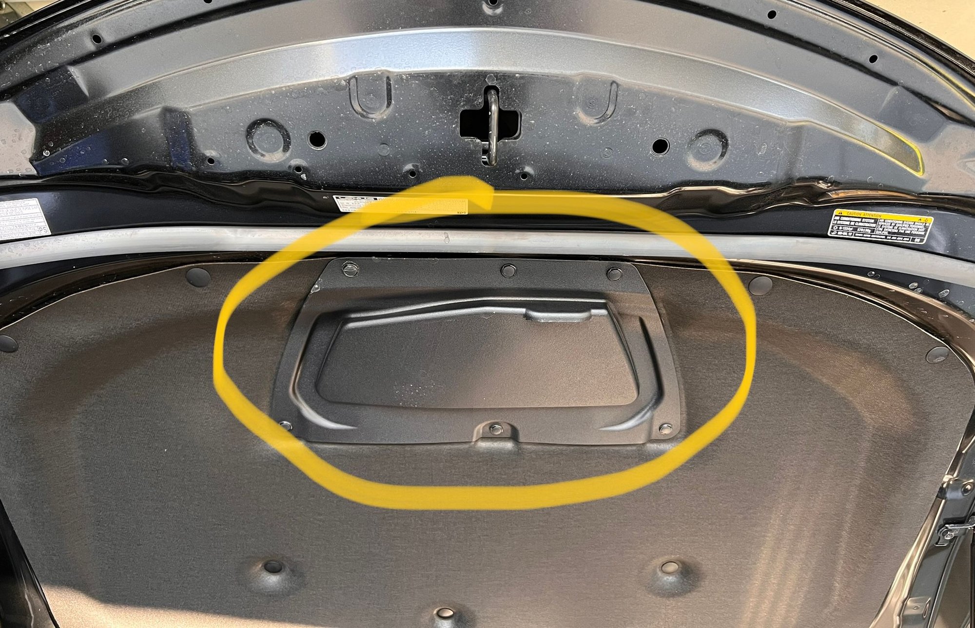

How did you guys take it off? Did you just pry off the plastic rivets?

^^^^Maybe you can see better here what nigel821 did:
I just took off the plastic rivets, pretty easy but they're easy to lose in the engine bay so put a hand under them when removing.
