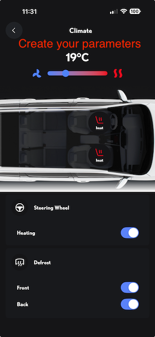

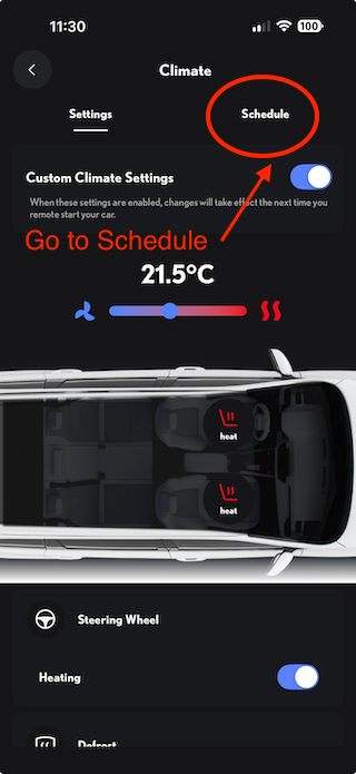

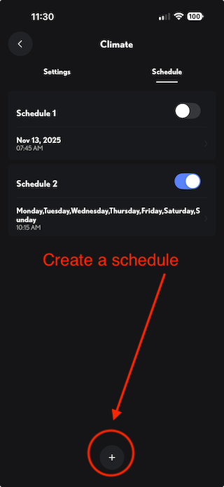

Try using the Climate option in the app instead of remote start to precondition your car. Also make sure that defrost is selected in default climate settings and also the scheduled climate conditions.
