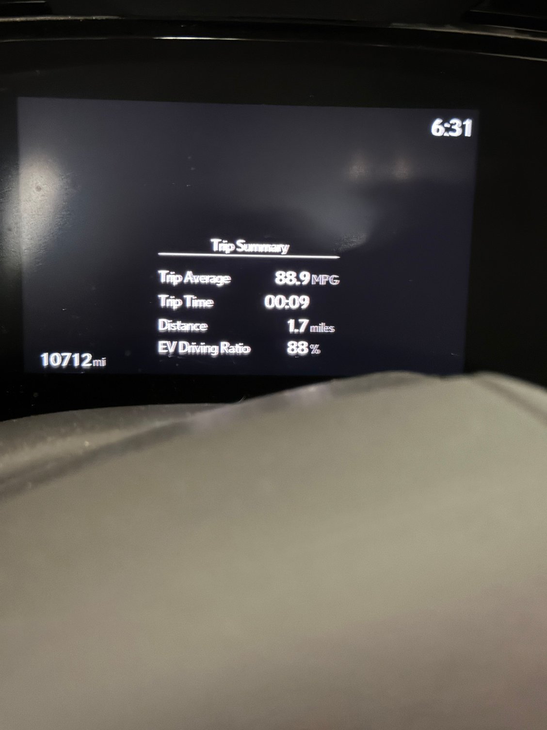

in my 2022 350h,I have driven 4 miles and gotten well over 65 miles per gallon since most of the trip was in EV mode.
I got 89 MPG the other day, driving a little under 2 miles.

Expected. You reset you mpg and drove 2 miles on 88% EV. Actually you can get 99.9 mpg if you try , but that short term mpg is basically meaningless. SORRY
