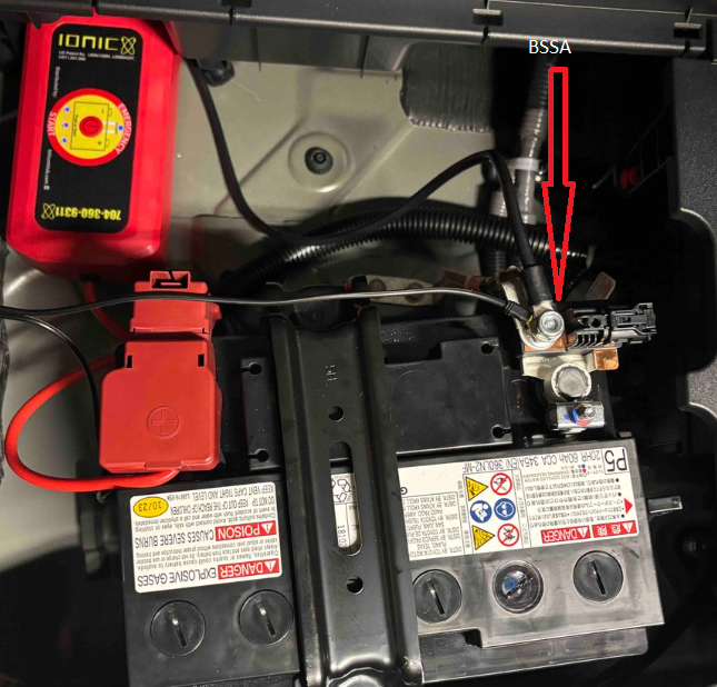

There is no need to crawl through the back to get to the battery. As long as the NOCO is ≤ 15.0 volts, it should be safe to use. To access the battery in the back, you can connect the positive cable of your booster pack to the positive post in the fuse box, and the negative cable to the strut bolts. That will power up the vehicle.Do not turn the power switch on (ready) and just open the back door to access your battery. (this is just FYI only)
The NOCOs are such a great size, don’t want to have to buy a larger charger in order to get cables that will reach the correct clamp spot. Empirically we know that the negative cable can clamp to the spots in @lsft video and not cause the ECU damage. But I’m wondering if those two spots are 100% safe. Guess we won’t know until someone fries the ECU and reports back here.
However, I don't reccommend anyone to jump start the car by connecting their booster pack directly to the battery posts either. The luggage room relay and junction block assembly is right under the battery. You could fry the Battery State Sensor Assembly that is attached to the battery negative post.
Follow the battery jumping instructions in your owner manual.

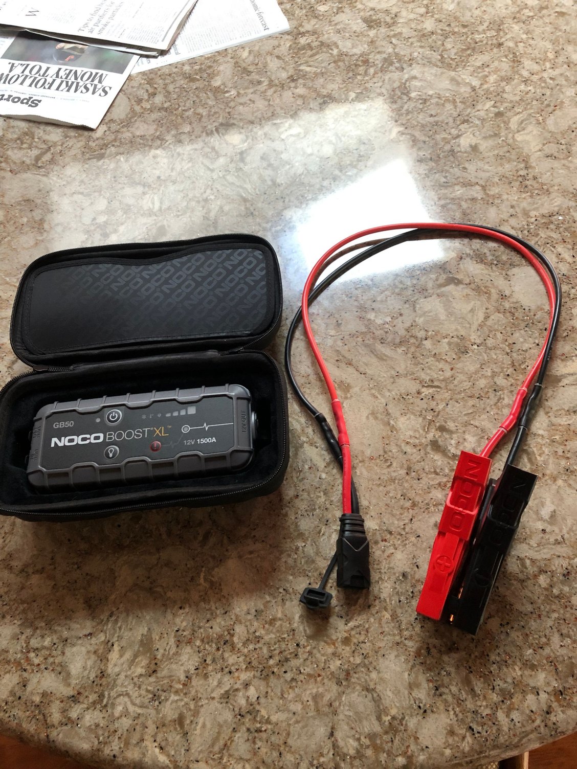

I opted to extend the two cables by adding a 24" section into both of them. This was very easy to do with the two items that I purchased on Amazon. I used my crimping tool and a heat gun on the shrink tubing.

I have two NOCO Boost modules, one for each of my 450h+ vehicles, and chose the 10 ft lengths in order to extend both units. I still have six feet of each of these cables and a box of the butt connectors, if anyone else needs them to use on their cables, let me know. They are for 8 AWG cable.
