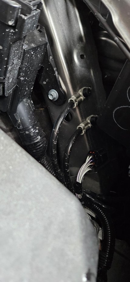

Originally Posted by NX450Guy
Since we’re not supposed to attach the negative cable of the NOCO to any clamp point within reach of the black cable (one foot long), and the spot on the engine we’re supposed to attach is about 3 feet away, has anyone found longer NOCO Boost Plus 1000 cables? Can’t find on Amazon.
I agree the cables are too short. I had a look under my hood and there are 2 ground cables bolted to the inside of the fender just below the fuse holder. I think it would be safe enough to clamp the black cable there. Those appear to be far enough away from the ECU module and following the cables as best I could, I didn't see them going to that module. I've had my car boosted twice and don't recall where the CAA guy clamped the ground to, but there was no damage to my ECU. So if and when I need to use my NOCO, I'll roll the dice and clamp it there. I'd be willing to buy a longer set if they made one, though.

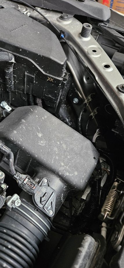

I did a quick update video since Lexus provided the nuts to not clamp. Not sure if you watched the first and not the updated one.
But this is where I clamped when I jumped my car 2 times.

These are the cables I'm talking about;
https://youtu.be/HpXu9uoOeuw
Thanks, I saw the first version of your “Do Not Do This” video where you were fairly certain it was okay clamp on the two nuts farthest from the ECU. But you weren’t 100%. Now it looks like you’re more comfortable to recommend those clamping spots since the NOCO negative cable won’t reach the Lexus manual’s preferred spot. I was hoping to take all uncertainty out of the equation by buying a longer cable, but that’s not happening unless I make it myself. I do feel better about about the alternative spots if you don’t think there’s a chance of frying the ECU with a jump there.
I've boosted twice with that nut, but again I could be lucky that it's not an issue. We do know that those nuts still connect to the other wires they said to not clamp via the metal. I haven't had to boost again since I do have a trickle charger and I've been charging it from time to time. Also, if the battery ever goes bad, I would just plug my trickle charger in to charge the battery again and really don't need the booster. Worst case, drive the other car and charge the 12V battery.
