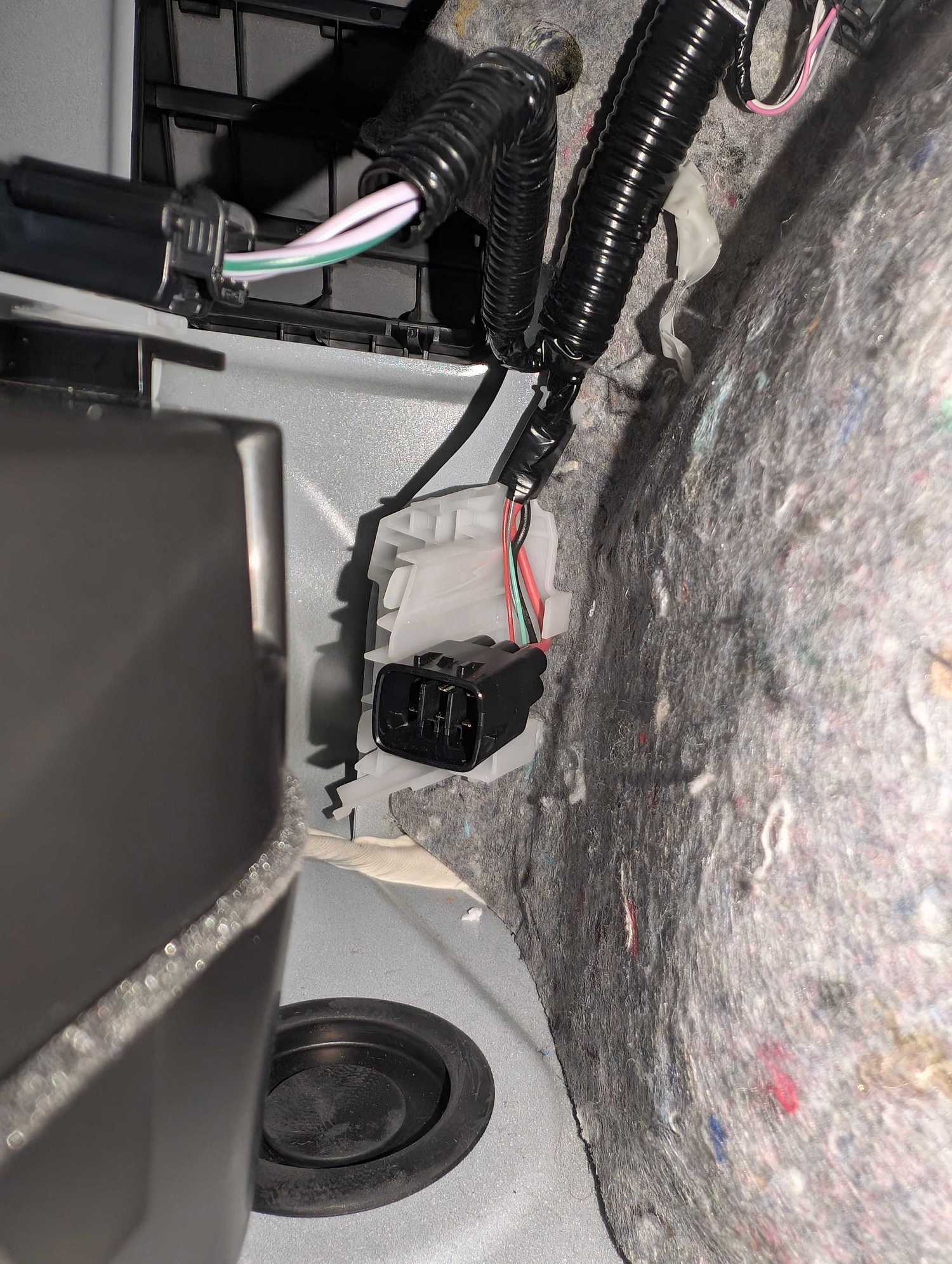

I recently purchased 2024 NX 250 Premium and wanted to upgrade the subwoofer. While trying to find a power source I could tap into I saw this unused socket behind the subwoofer. Anyone knows what it was intended for?

Saw it too, no clue. Maybe someone with the electrical schematics can chime in. The other issue is finding a connector to fit, or just tap off the wires if the red/black is the accessory outlet power. You can run a meter and see if it has power, and remove the accessory fuse to see if it goes off. If it is the accessory power, much easier to tap there then to pull the socket out and tap to the wires from that. Keep us posted.

Just a crazy idea, is that the plug for the ML sub?

Perhaps its the plug for the towing hitch wiring.

This guy with the same socket that connected to something. Maybe you can reach out to the poster and ask what it connected to.
