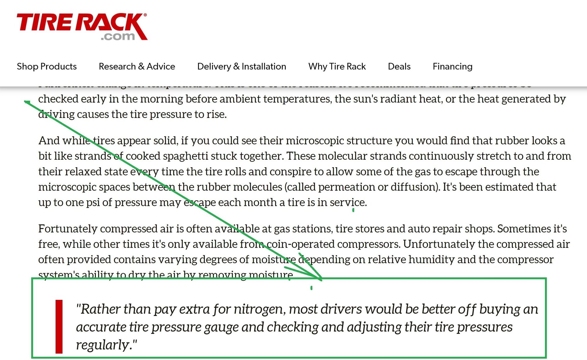

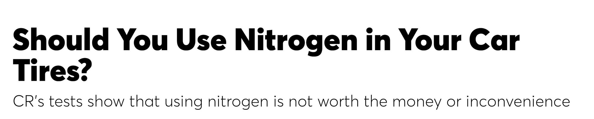

Nitrogen costs and has minimal benefit. Some tire stations charge $5-$10 to fill tires. New Dealers charge around $100 or more. There is profit to be made if the dealer or tire station wants to pursue it. CR and TireRack don't recommend Nitrogen filled tires.
YMMV,
MidCow3
