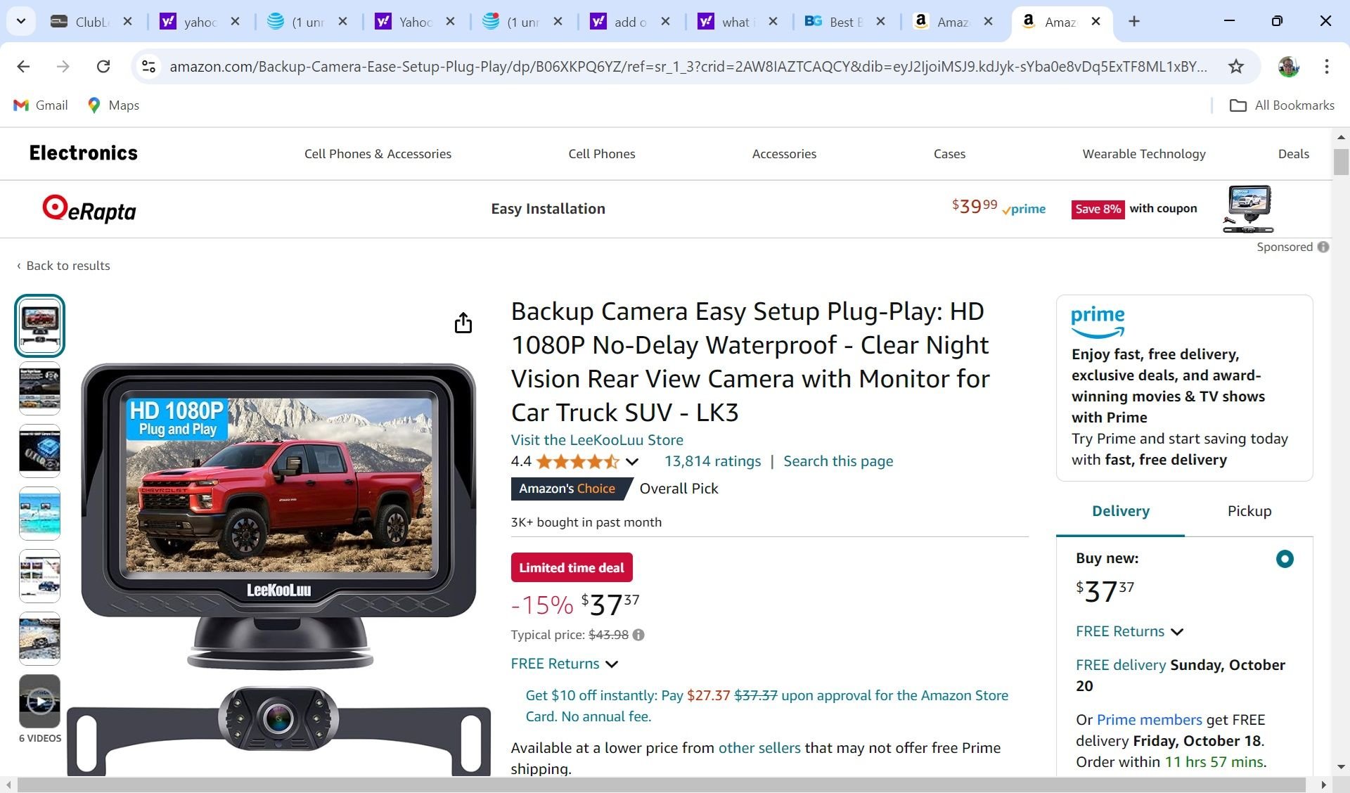

Lightbulb add-on backup camera ?
Why not look at an add-on rear view camera ? Here is an inexpensive one from Amazon.
