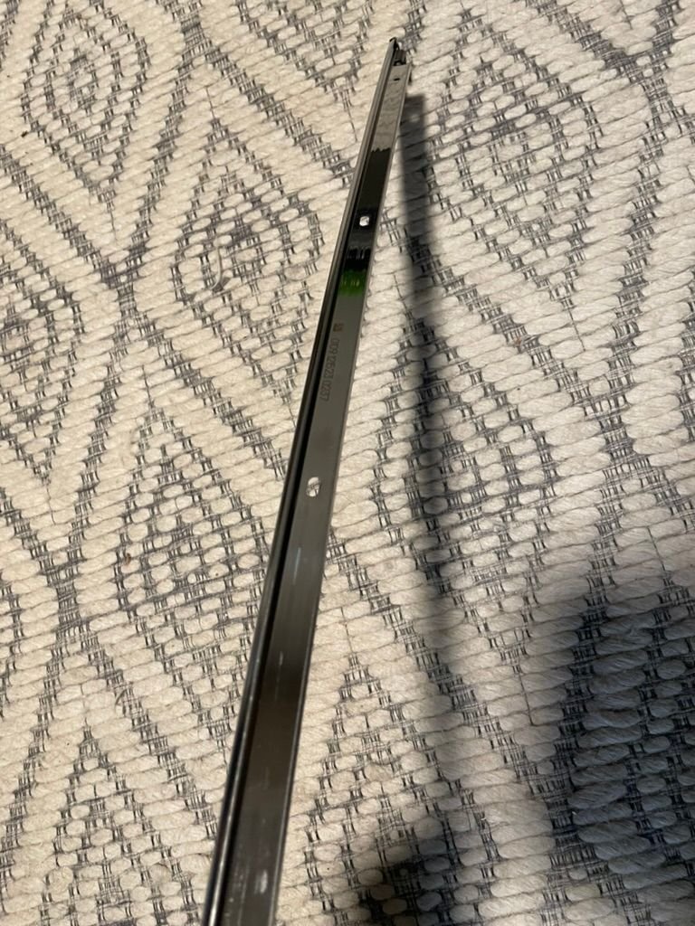

Old Jun 11, 2024 | 10:35 AM
jsmith's Avatar
jsmith
Joined: Jul 2001
Posts: 234
Likes: 50
I am hoping folks that did the F-Sport trim conversion can chime in. This is what the part looks like. I read somewhere that Lexus usually uses pop-rivets on those holes to secure to the frame. I'll check a local auto body who might do it for me. Otherwise, this is unknown territory and I'd have to get a pop-rivet tool on Amazon.
Old Jun 15, 2024 | 09:10 AM
jsmith's Avatar
jsmith
Joined: Jul 2001
Posts: 234
Likes: 50
I followed this procedure for a later model Camry. I got the Toyota spec pop-rivets on Amazon - there are links in the video description. I got a cheap pop riveter ~ $20. The trim was $60 75764-F6010 (the trim shown in the video is different of course but basically the same design ). I used a 7/64 drill bit. Watch that lower trim, I nicked mine in one spot, the bit drops right thru when it gets thru the rivet. Suggest using masking tape to avoid scratches until you're finished.
Install procedure variance - you need to start at the rearward end to tuck in the trim before you do the front-facing end, otherwise it won't tuck in after you snap the front in.
