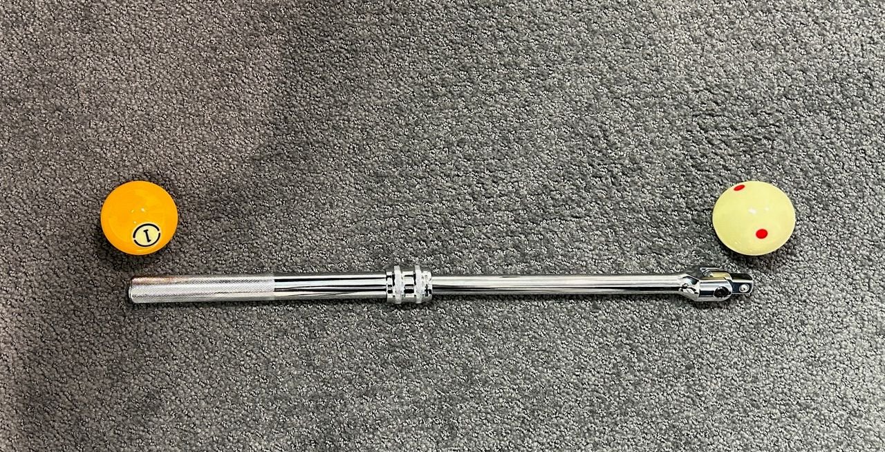

Default Husky from Home Depot.
Nicely made...good feel. It works. ...extendable
