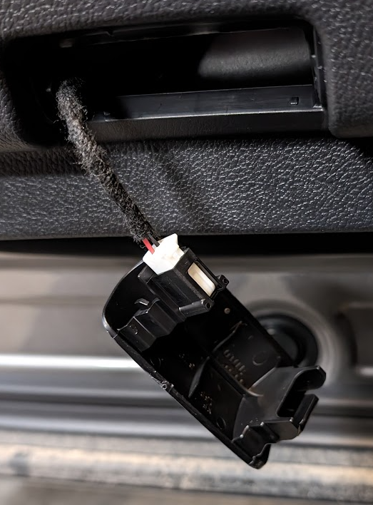

Just posting some photos here for reference.
My 2024 450h+ (built in Japan) did not come with puddle lights.
Opening the blanks, there's a connector already wired and in place.
Installation of the 3rd party (or OEM) lights are a 5 minute job.
Regarding delivery time from 'addcarlights' - I ordered on Feb 25th and got them in my mailbox (in Canada) on Mar 5th. So just over a week.
Blank plate on Front Left and Right doors (there are none on the rear doors)
pre-wired from the factory and held in a dummy connector.

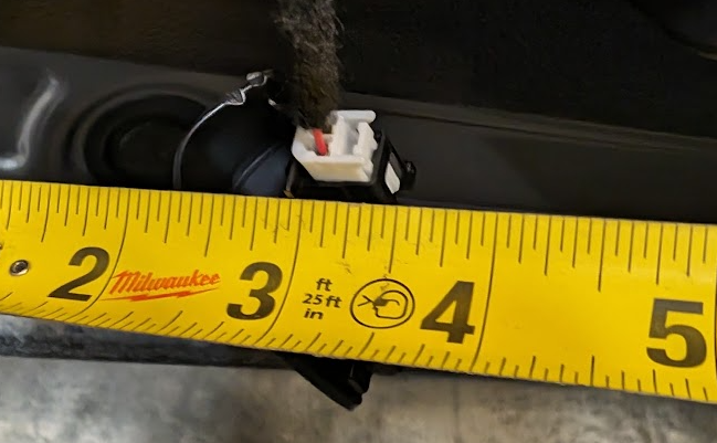

Size.. if ordering from addcarlights, this is what they call the 'small' connector.
