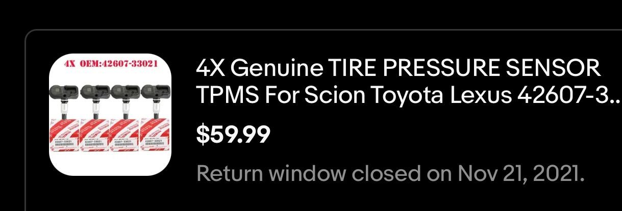

You can buy OEM Toyota TPMS on eBay for a lot less than that! I got four for $60 USD

Thanks for the reply . Will part # 42607-33021 work in my 2023 lexus nx 350? I believe the Lexus part number I need is 42607-06090

I don’t think so. I was just sharing as an example. That was for my 2008 ISF.
