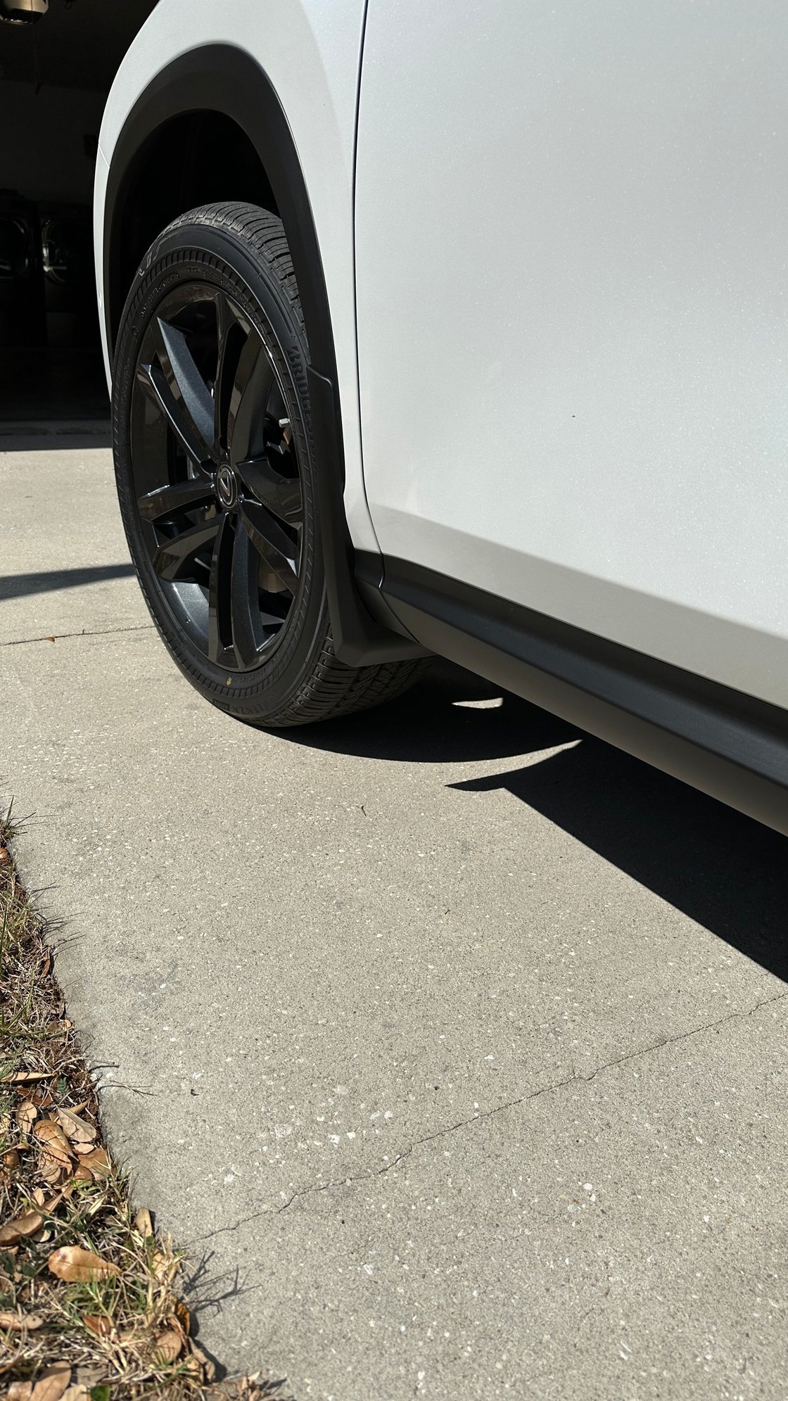

Okay, I got the mud guards installed today. I'm not really sure I like the design. There is a deep cavity all the mud, rocks and debris will be caught in and will have to be emptied on car wash day.
Unfortunately for me I didn't have the proper tools to be able to install without having to take the rear wheels off. But it's all good. I was able test the Modern Spare Jack and equipment I purchased as well. Everything went good.
Driver Front from the front
Driver Front from behind
Driver Rear from the front
Driver Rear from behind
