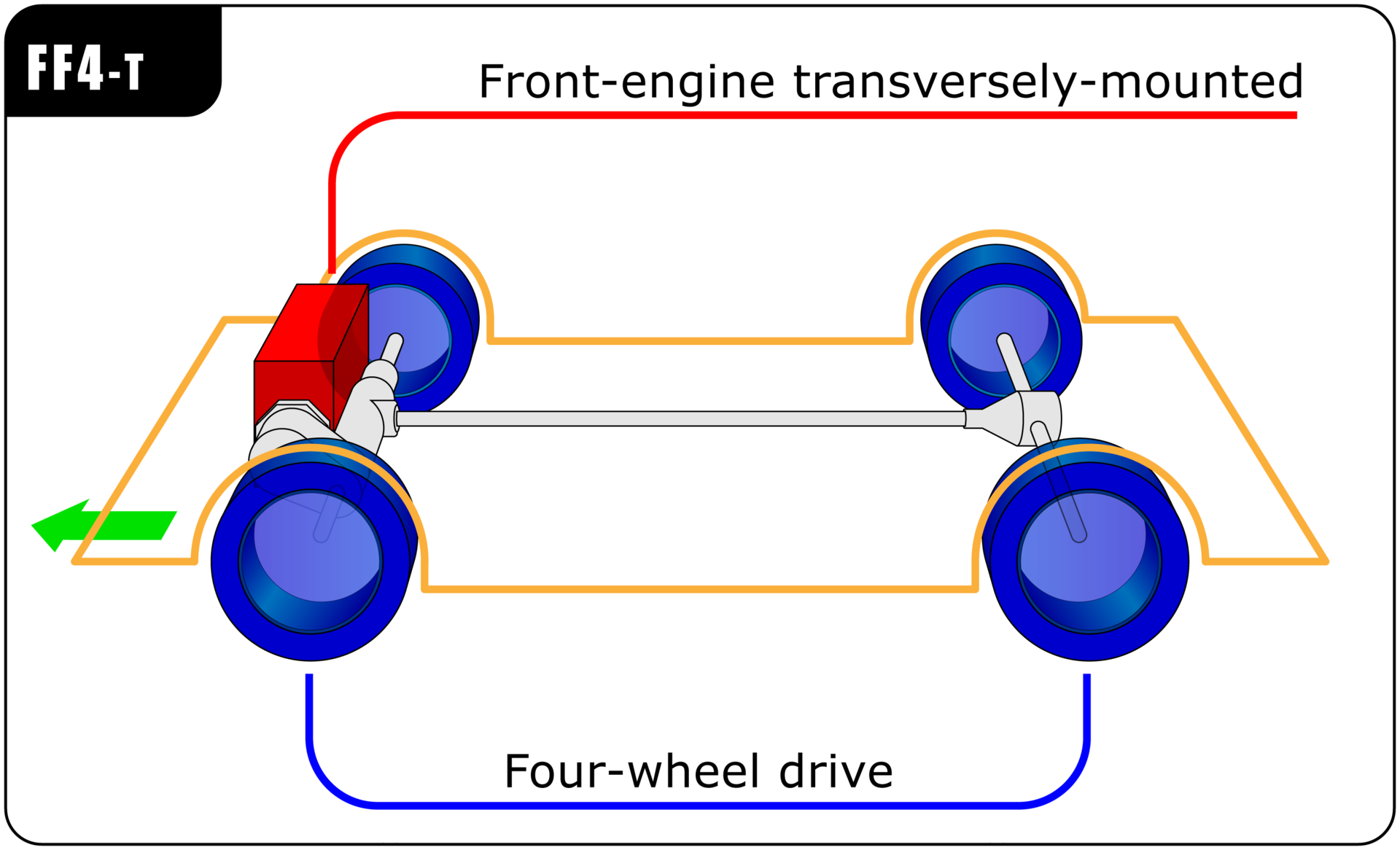

However, because NX is still FWD-based with the engine in front of the front axle:
1) It is still nose heavy with reluctant turn-in [slow changes in direction] unlike GLC and X3.
2) It tends to use more trailing and king pin angle in the steering for straight line stability, but this results in even heavier steering with more self-centering effect.
Here, the RWD-based GLC and X3 will have lighter power steering, with tighter turning circle for more U-turns and fewer 3-point turns, less self-centering of the steering wheel, no torque steer under power, and more power oversteer for more throttle steering with more work with the right foot rather than hard work with the two hands.
FWD-based platforms have the advantage of:
1) Saving money.
2) Easier for novices to drive FWD-based vehicles in snowy white winters.
NX:
